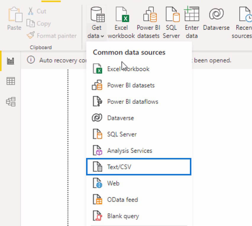

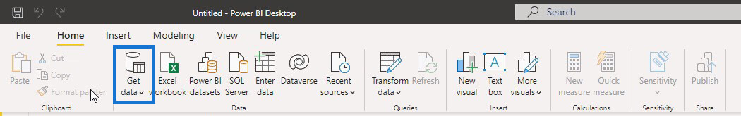

To bring a CSV file to Power BI, the first thing you have to do is click on the “Get Data” menu in the Home ribbon.
After clicking, a dropdown menu will appear and you have to select the “Text/CSV” option from the menu.

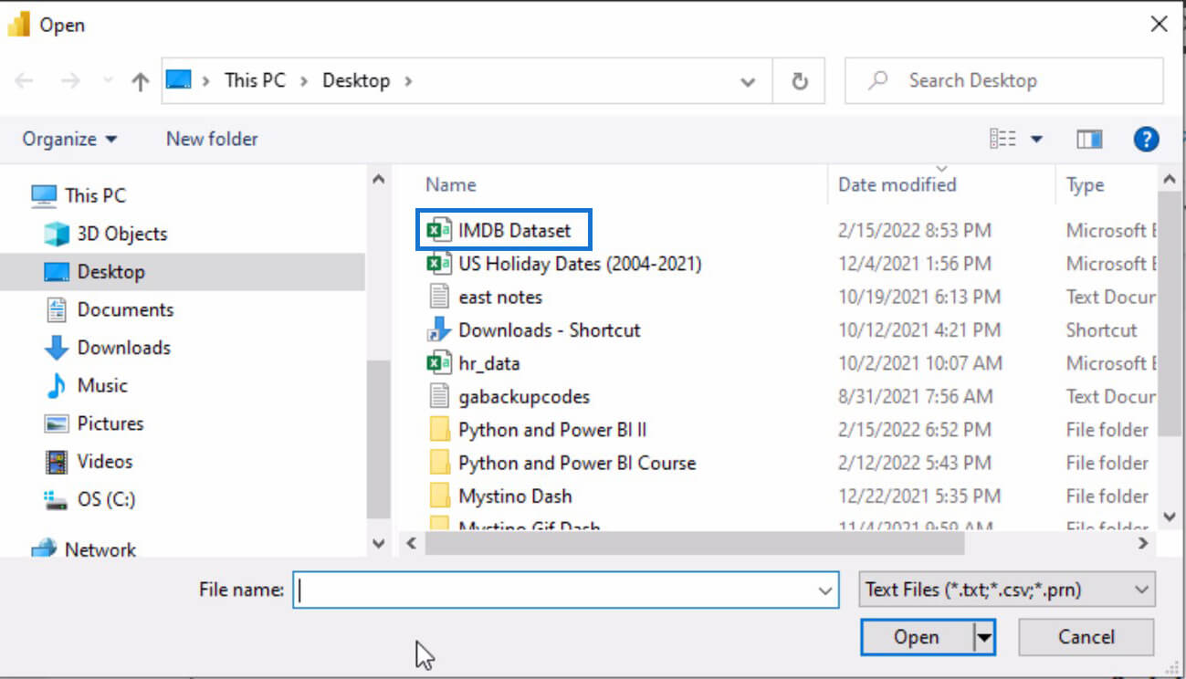

Once you select the “Text/CSV” option, a window will open where we can select the file that we want to bring into Power BI. For this example, let’s use the IMDB Dataset file.
Python dataset
Upon opening the IMDB Dataset.csv file, you’ll see another window that displays the data inside that file. Since this file contains a large amount of data, it only previews some of the data.

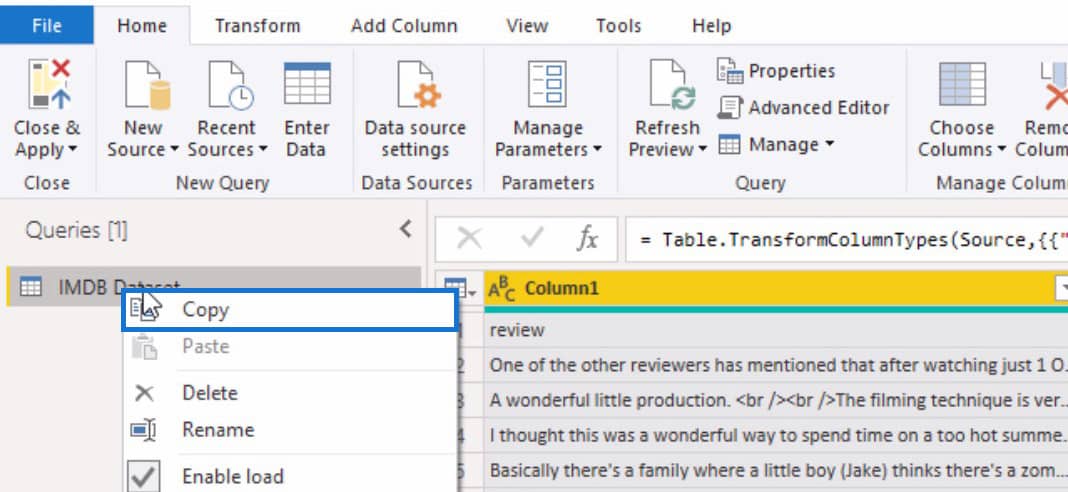

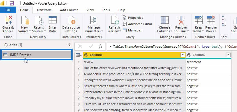

Before we make any changes to this dataset, it’s important to make a copy of the original dataset. To do this, just right-click on the dataset.
Python dataset
Then from the menu, select “Copy”.
Python dataset

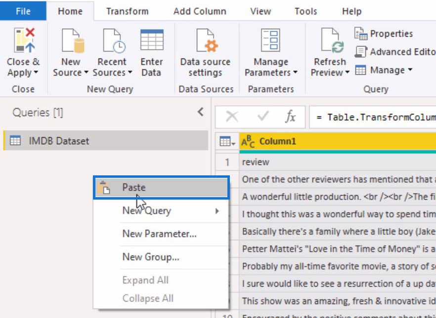

Lastly, right-click on the Queries panel then select “Paste” from the options.
Python dataset
After applying these steps, you should have a copy of the original IMDB Dataset in the Queries panel.

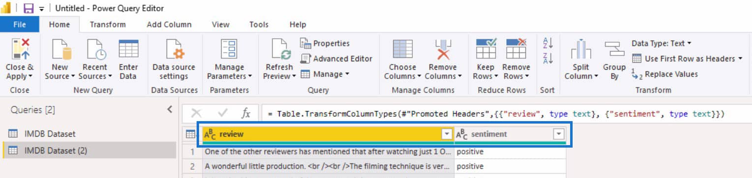

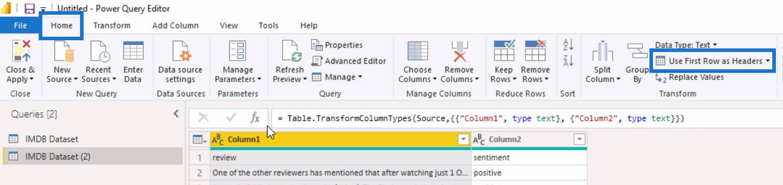

But first, we have to make sure that the headers are properly lined up. Click on the Home menu then look for the “Use First Row as Headers” option and click it.
Python dataset
After clicking the “Use First Row as Headers” option, the headers now changed into the data from the previous first rows which are “review” and “sentiment”.
Python dataset

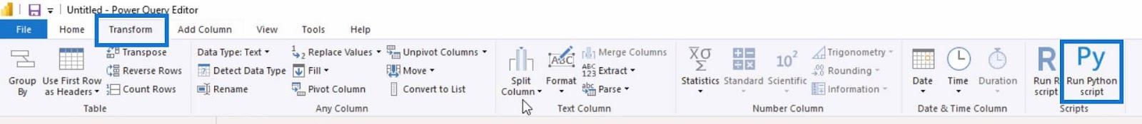

Next, go to the Transform menu and click on the “Run Python Script option in the “Scripts” group of options.
Python dataset

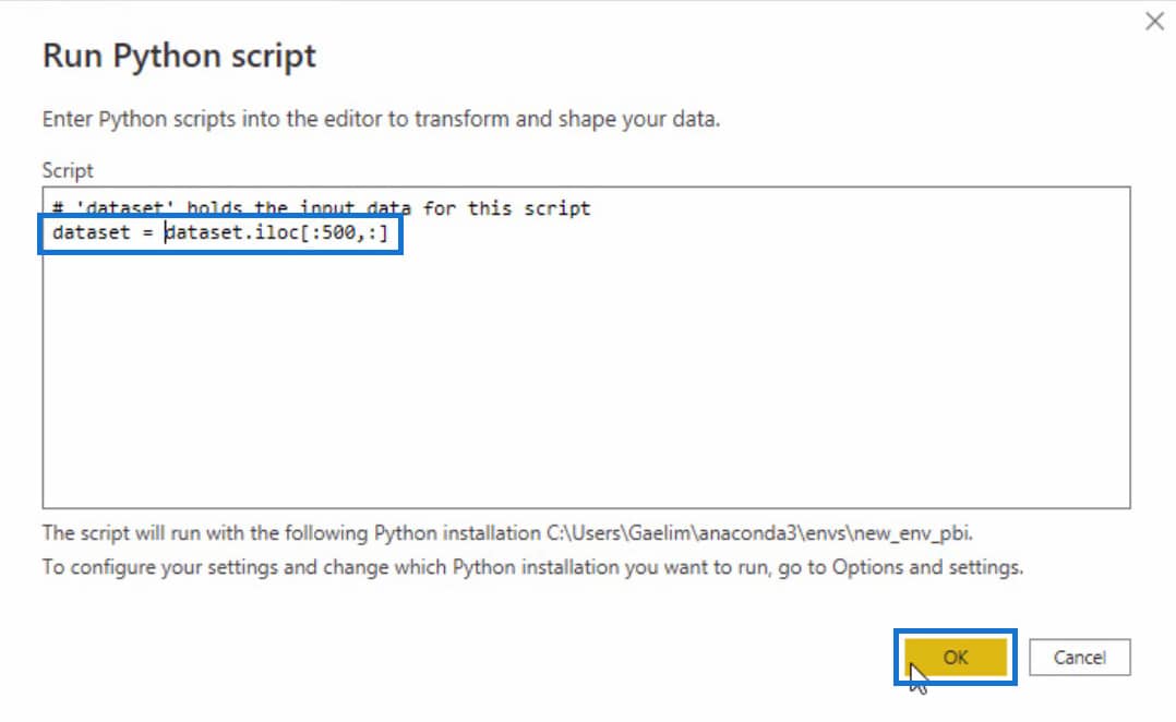

After that, a “Run Python Script” window will pop up. In this window, you can run any Python script you want in order to transform the current file that you’re using. For this example, I’m going to make the dataset smaller by running the following code.
Python dataset
I used the .iloc function on the dataset to select the specific rows and columns from the IMDB Dataset. Then, in the parameters, I selected all the first 500 rows and all columns in the IMDB Dataset. I stored it in a variable named “dataset”.
After executing the script, we should see the “dataset” which is the variable we’ve created in the previous step. It contains the data we’ve altered using the Python script.
Python dataset

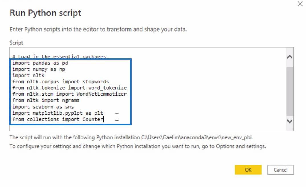

To import the libraries, let’s go back to our notebook and copy the libraries that we need. Keep in mind that prior to this tutorial, I’ve already created these libraries we’re about to copy. I’m just reusing these for you to clearly get the idea about the usage of functions as repeatable codes.
Python dataset

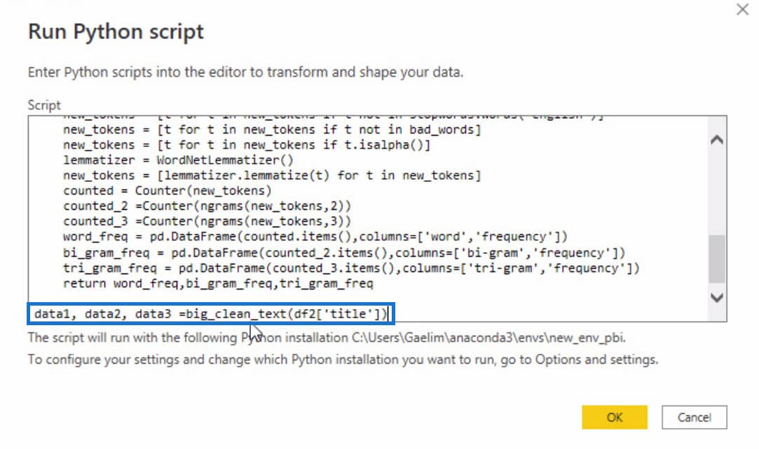

Once the libraries are copied, paste them into the “Run Python Script” window, and don’t forget to include the line “from collections import Counter” at the end of the script.
Python dataset
Then we’ll copy the data cleaning function from our notebook and add it to the Python script in Power BI.
Python dataset
We’ll add it below the libraries.
Python dataset
We’ll also copy the code for calling the function that we just added.
Then paste it into the Python script in Power BI.
Generating Data Tables
Now that we’ve added the code for calling the data cleaning function, we need to change “df2” into “dataset” and the “title” to “review”. We did this due to the changes we’ve made in the dataset.
We changed “df2” to “dataset” because we stored the data with 500 rows in “dataset”. Then for “title”, we updated it to “review” as a result of changing the headers of the columns.

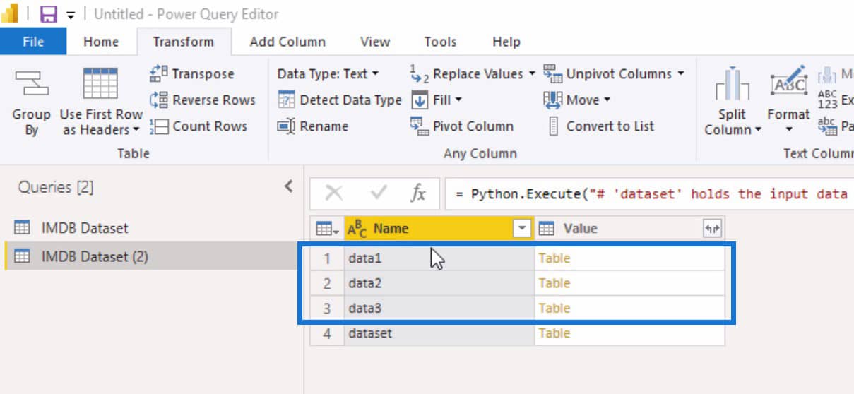

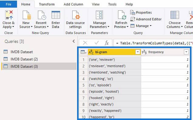

With these codes added, we should be able to get or generate 3 tables which are data1 for word frequency, data2 for bigram frequency, and data3 for trigram frequency.

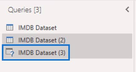

You can also make another copy of this altered IMDB Dataset (2) to open another table later on.
Now in IMDB Dataset (2), let’s open the data1 table
 Once the data1 table is opened, we can see the list of words as well as the frequency.
As you can see, we’re able to perform certain procedures from the main dataset with the use of repeatable codes that we took from the Jupyter Notebook. With those repeatable codes, we’re able to transform a Python dataset and generate a table for word frequency, bigram frequency, and trigram frequency without typing the codes all over again.
In IMDB Dataset (3), let’s open the data2 table to see the bigram frequency.
In the bigram frequency table, you can see the “br” included in the list. This is probably connected to an HTML code. We can simply go back and add something else but we’re not going to do that in this tutorial.
