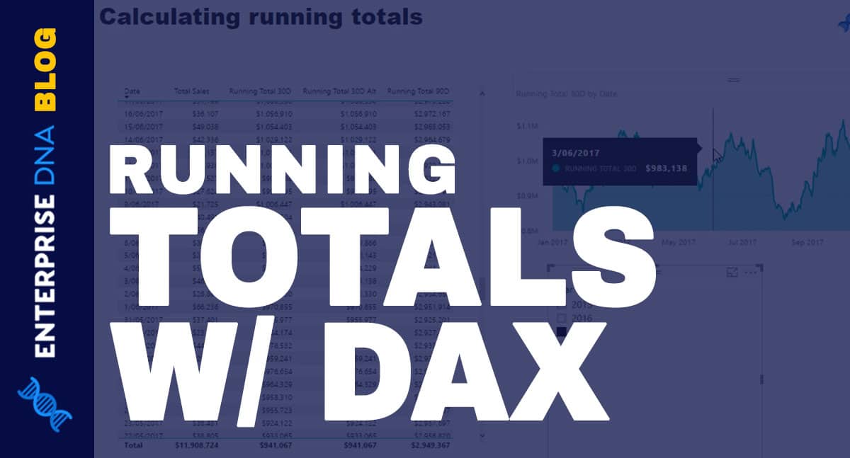

This is ultimately what we want to achieve as a result. We have our Date and Sales columns, as well as a 30-day running total and a 90-day running total (left side).
We also put them into visualizations to make the numbers more interesting, and to make trends and outliers easier to spot (right side).
We can also change the time frame and see our running totals change in real time. Quite a compelling insight, right?
