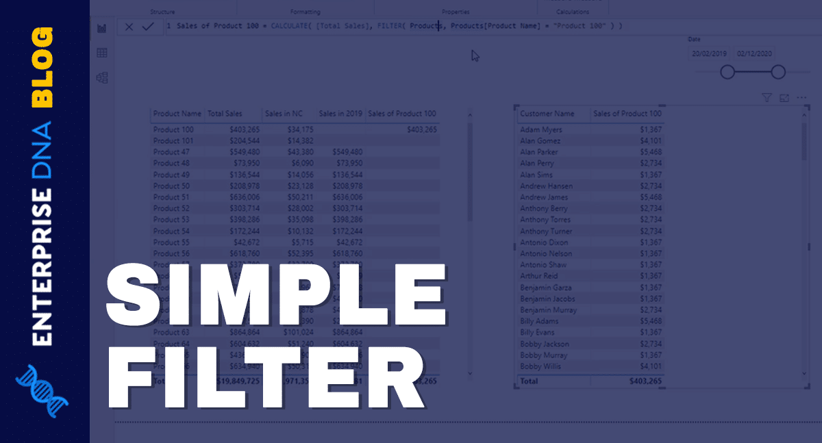

To show an example of how it can go wrong, I will create a new measure called Sales of Product 100 to look at the sales of just one product.
I will use CALCULATE again and use Total Sales as the expression. Then, I will insert my Product Name column from the Products table, set it equal to “Product 100”, and drag in the measure.
Because of its initial context, the measure puts the Sales of Product 100 in every single row.
The CALCULATE function cannot differentiate based on the simple filter that we used since the Product Name column is in a table.
To fix this, you need to use the FILTER function and put it in the Products table.
As you can see, we finally got the value we needed just for Product 100.
The tricky thing here is that you get different results based on the different contexts that you have.
For example, if I use the Customer Name as my context and change back the simple filter without the FILTER function, the result is displayed normally.
The reason why I always default to using the FILTER function is because it would always work for both cases.
To avoid confusion, you should always use the FILTER function as best practice.
