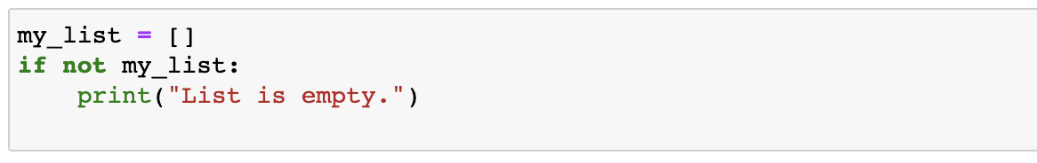

What is ‘if not var’ in Python?
if not var is a way to check if a variable is considered False in a boolean context. These might be values such as None, False, 0, or empty collections like [] or {}.
Here’s an example:
Example of if not var in python
