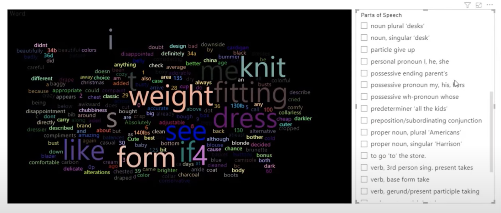

In this tutorial, we will use an out-of-the-box word cloud containing the texts that we’ll be evaluating. This is shown on the left side of the image below. On the right side, we have the filters to identify the different parts of speech, for example, adjectives or verbs.
Source Data
We can filter out words that are adverbs, nouns, different types of nouns or verbs, and verb bases. This is very useful when creating a marketing campaign and looking for words in your customer reviews.

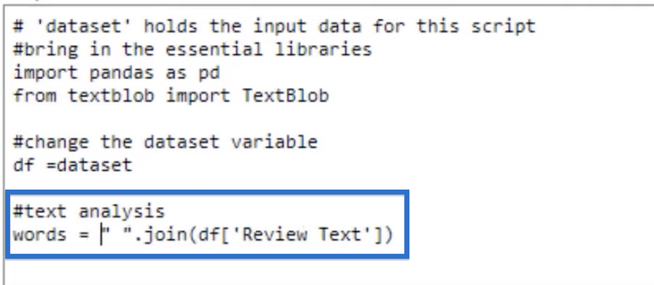

Let’s proceed with our text analysis. Recall that our review texts are in a column with individual cells. This setup is not really helpful to us because we want all the texts together so we can perform an analysis on it.
However, we don’t want them to be joined without a space, so let’s start our code with a space inside a double quotation mark.
Then let’s add .join and isolate our review text column by using our df variable, which holds the dataset. Type ‘Review Text’ placed inside a bracket notation which isolates the column.
This code will join everything, but we need to save it so let’s create a variable called words.

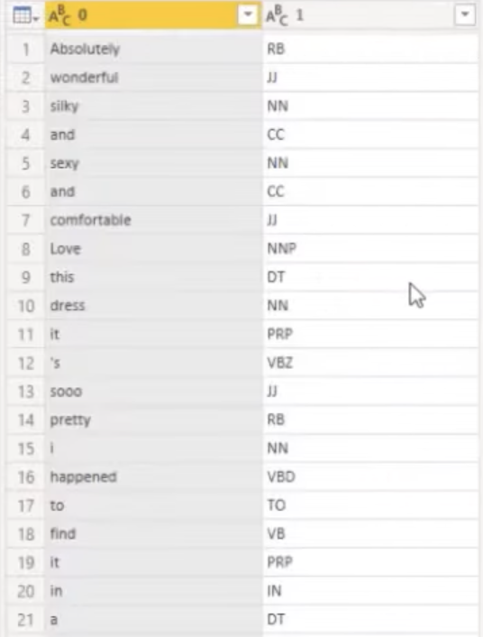

Now, we want to open our data, the last variable that we brought in to see what that looks like.
Fixing The Code For Text Analysis In Python
We should have all our words broken up by parts of speech. We didn’t name our columns yet, but we can easily do that.
