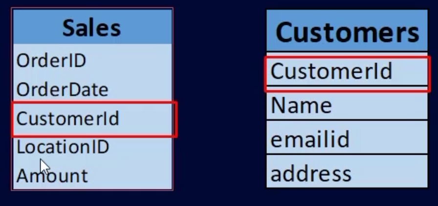

For example, let’s say we have these 2 tables.
subquery in sql
This is the problem that we need to solve. We need to get the customer name, email ID, and address of the customers who bought in 2022. This is not possible by only using the Customers table because there’s no record of sales or order date column on that table. We have other ways to solve this.

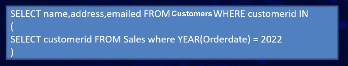

Instead of manually inputting their IDs, we can do it automatically by using a subquery in SQL. We can use it together with the IN condition to automatically bring the customers’ ID or whatever data that we need to solve a certain problem.
This is an example of what we can do to solve the problem. In this sample query, we’re selecting the name, address, and email ID of the customers from the Customers table based on their customer ID that’s coming from the nested query. In this nested query, the customer ID is coming from the Sales table with an order date of 2022.
With this technique, we don’t need to manually input the customer ID of the people who bought from the year 2022. It will be automatically fetched from the nested query that we’ve created.

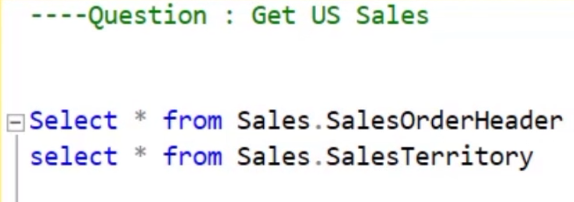

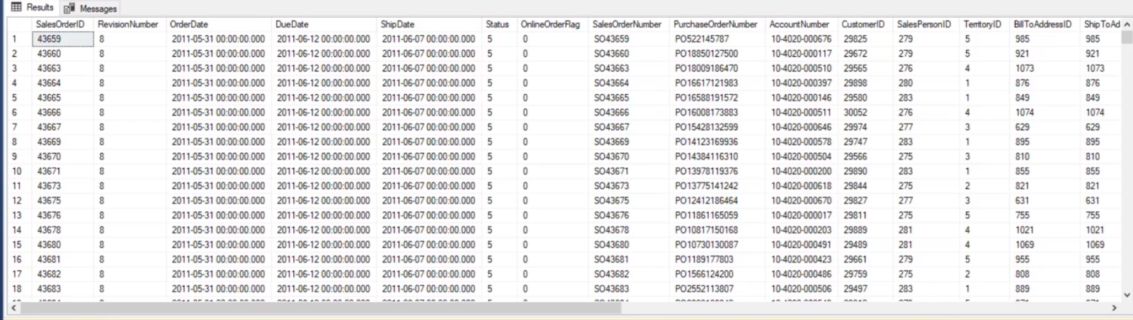

Let’s now have a similar scenario and this time, let’s do it within the SQL Server Management Studio (SSMS). In this example, we have two other tables SalesOrderHeader and SalesTerritory
subquery in sql
Our goal is to get all the information on the SalesOrderHeader from a US country region. On the SalesOrderHeader, we don’t have the country region column.

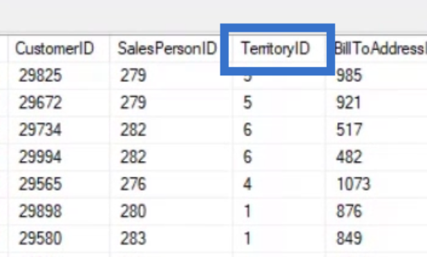

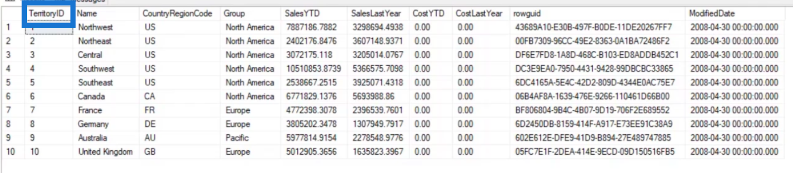

However, we can use the TerritoryID column that’s also available on the SalesTerritory table. That’s where we can also get the country region information which is the CountryRegionCode column.
subquery in sql

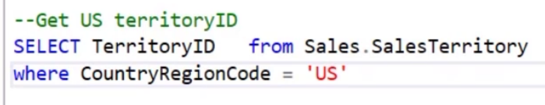

Again, we can do this manually by getting the TerritoryID first from the SalesTerritory table with a US country region.
subquery in sql
We’ll then have the list of TerritoryID under the US country region.

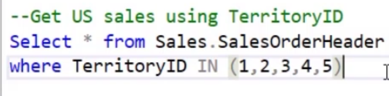

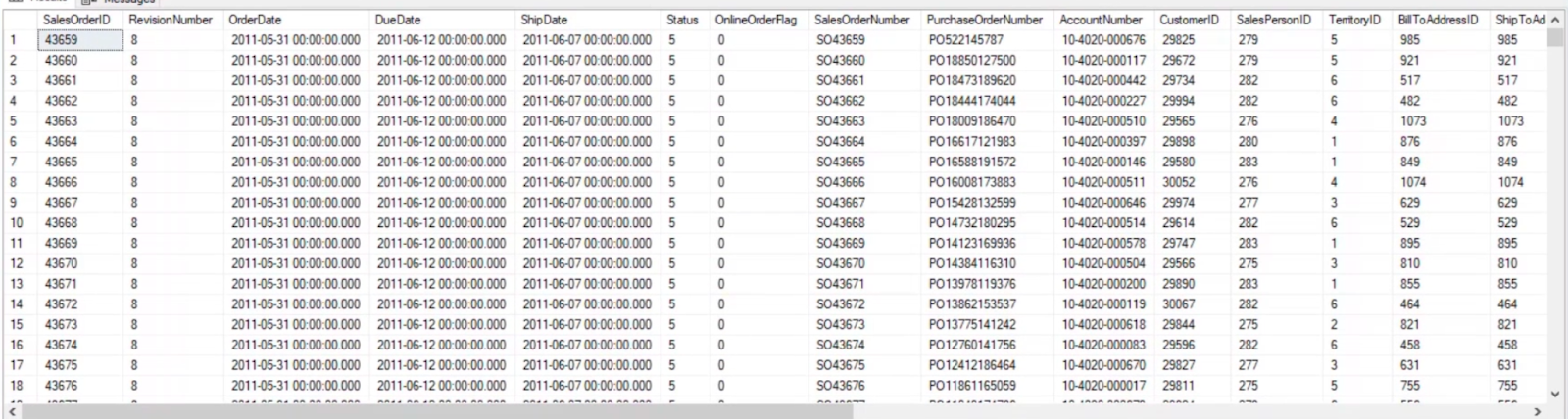

After that, we can use those IDs to get our desired result by manually inputting them on our query.
subquery in sql

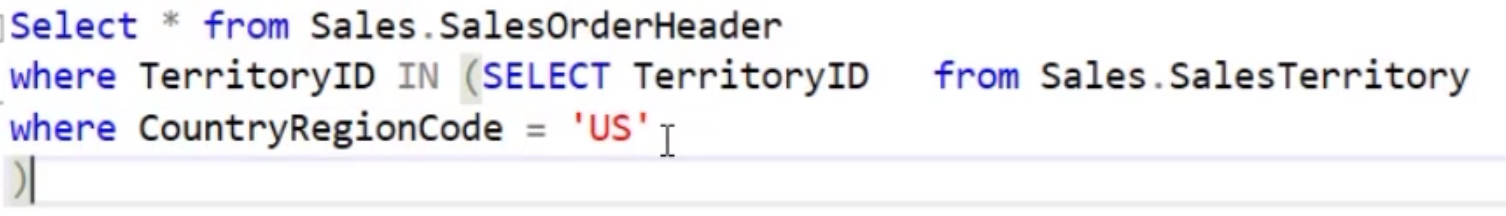

But instead of manually inputting the IDs, we can do it easily by using a subquery. We just need to replace it with our first query where we’re getting the TerritoryID on the SalesTerritory table with a US country region.
subquery in sql
It will then give us the same result as the manual process.
