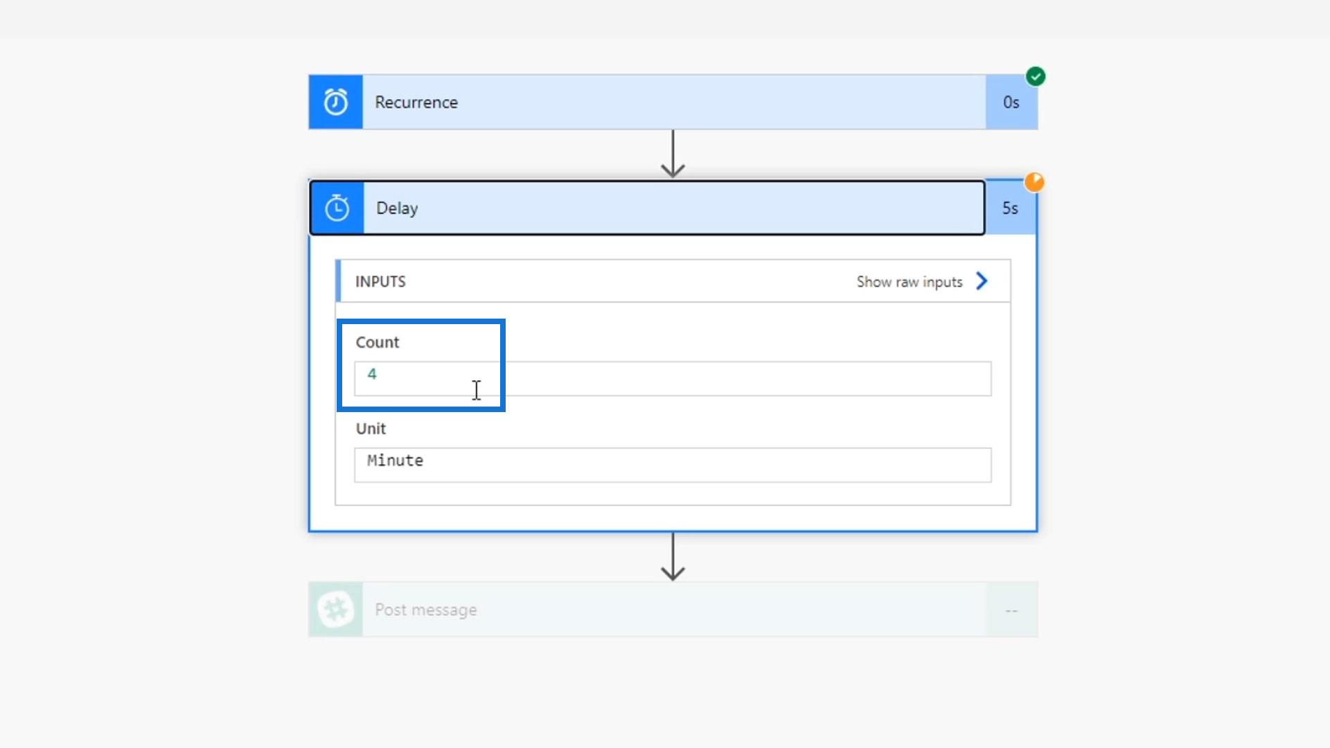

So, we’ll use an expression instead. We’ll set a random number from 1 to 5. Under the Expression tab, let’s look for the expression called rand. This takes in a minimum and maximum number or integer and generates a number between them.
Inside this rand() expression, let’s use 1 as the minimum and 5 as the maximum number. Then, click the OK button. This will delay our flow to a range of 1 to 5 minutes.
After that, let’s save and test this flow.
Testing The Delay Action
Choose the first option, then click the Test button.
Lastly, click the Run flow button.
As we can see, it used 1 as the random number. Instead of posting the message at exactly 9:00 AM, it will wait for 1 minute after 9:00 AM to post the message. We can also see the countdown of the delay at the top right portion of the Delay action.
After a minute, our message will then be posted to our Slack channel.
Let’s try to test it again to see if the random number will change.
For this result, it used 4 as the random number. This means that the flow will wait for 4 minutes before posting our message.
And that’s how the Delay action with rand() expression works.
