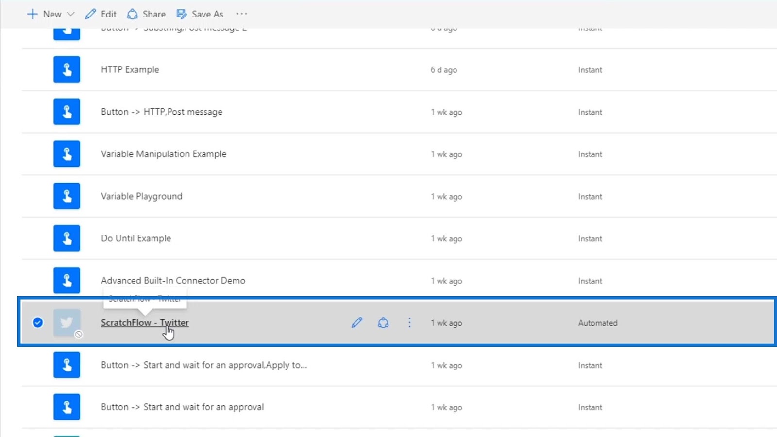

Let’s check out this sample Power Automate flow.

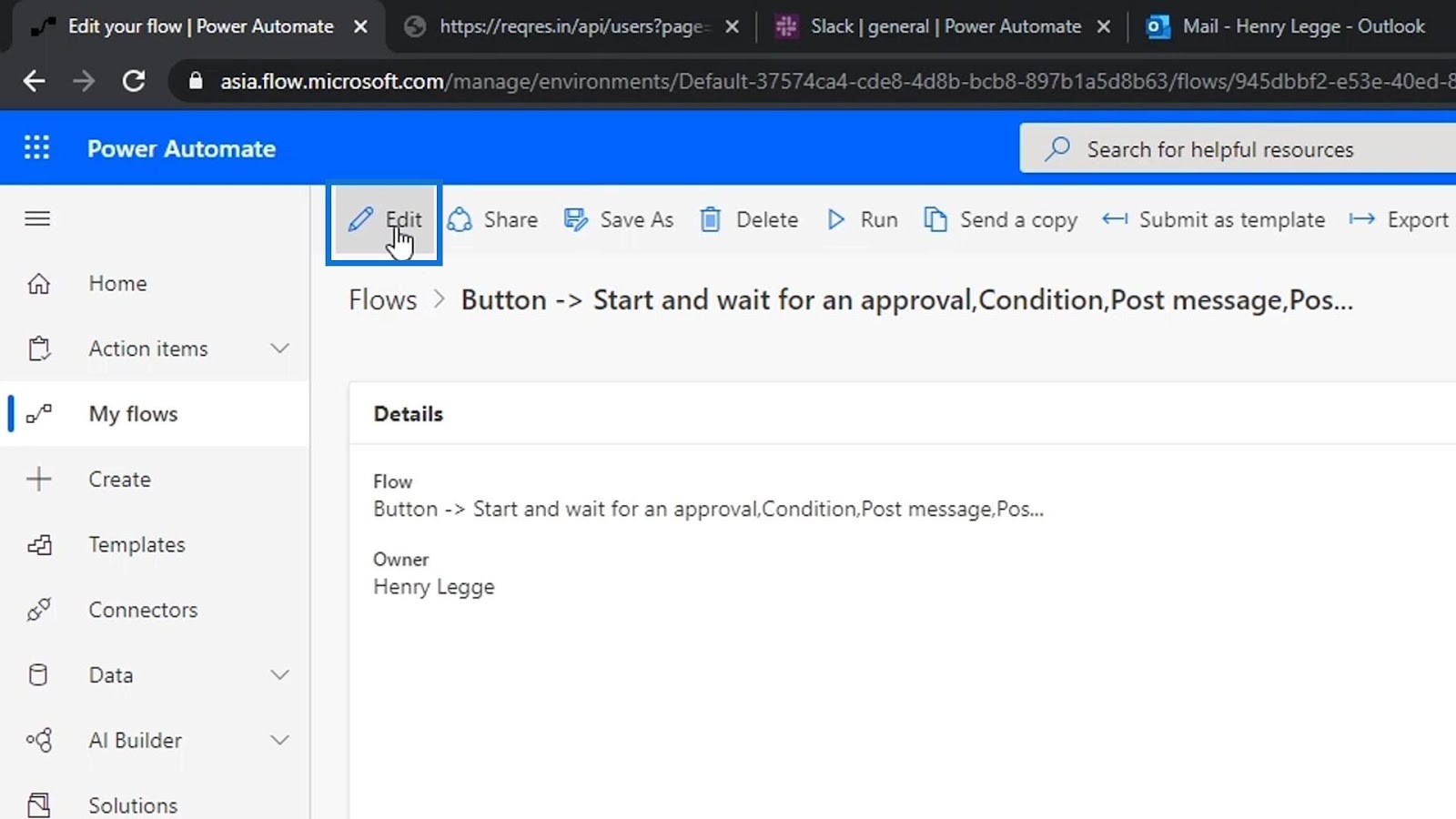

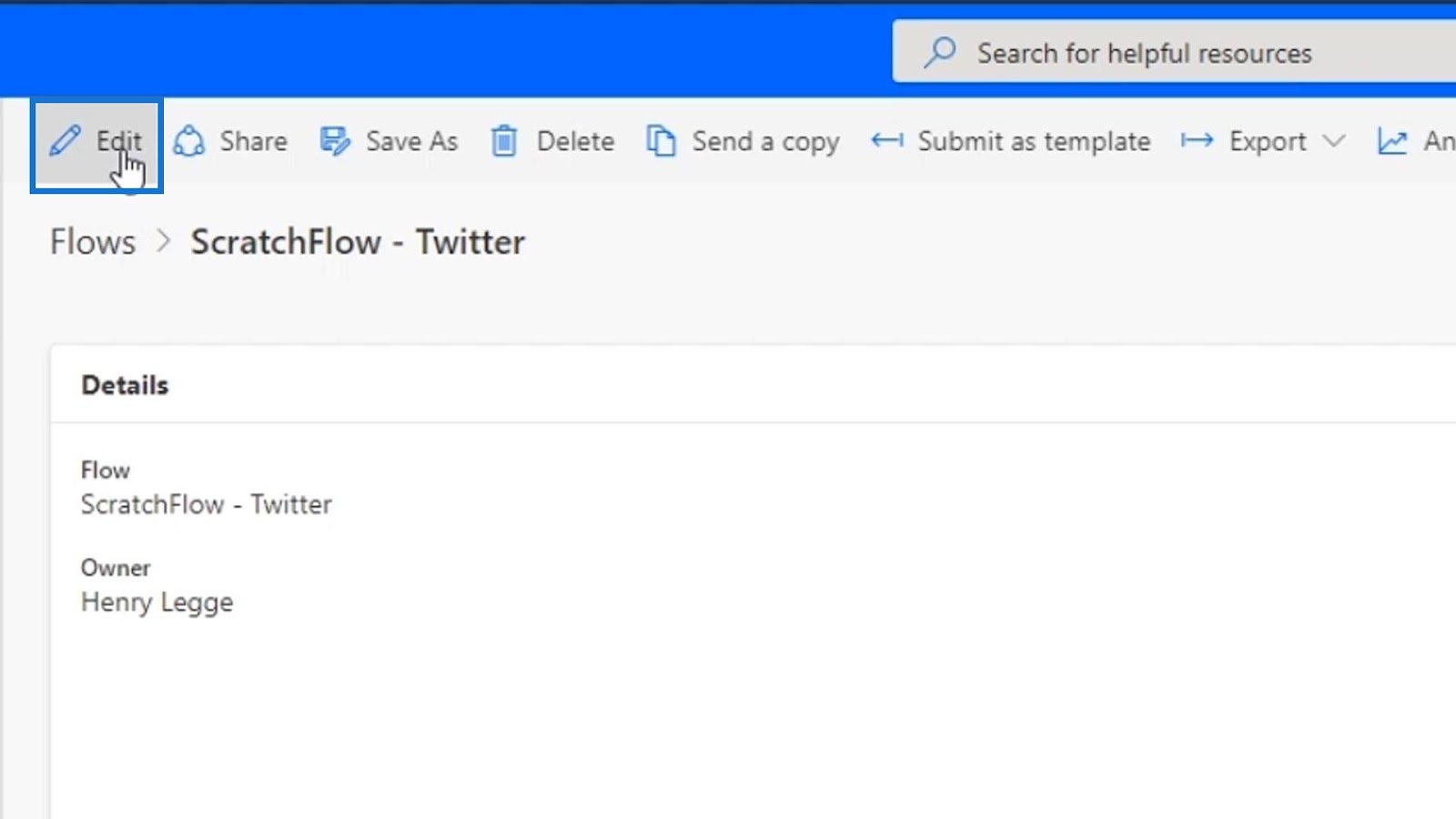

Click Edit.
scope control

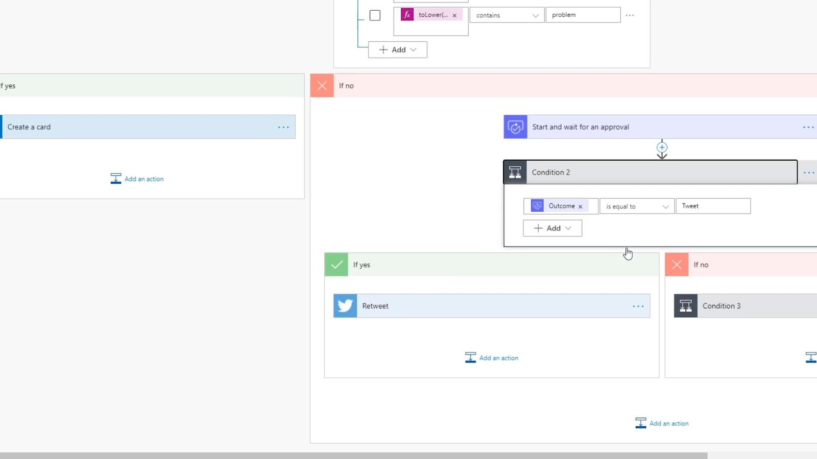

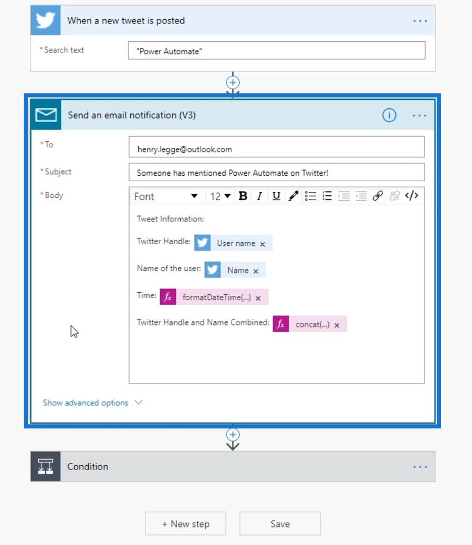

This flow is quite complicated. When a new tweet is posted, an email will be sent.
scope control
Then, it’ll trigger a condition that has another set of nested conditions within.
scope control
What we can do to organize this is to group similar actions into the same scope. We’ll talk about the advantages of doing that later. For now, I just want to go through a sample scenario where it’s useful to group things together.

Click Edit.

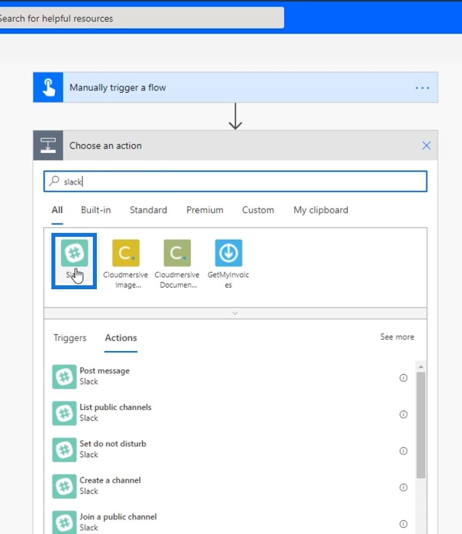

Let’s also add another action before the HTTP action.
scope control
Search and click the Slack connector.
scope control
Then choose the Post message action.
scope control
We’ll post a message to our general channel saying “Flow has been started; pinging the HTTP server”.

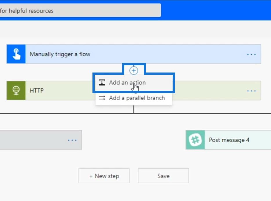

To do that, click the plus icon then click Add an action.
scope control

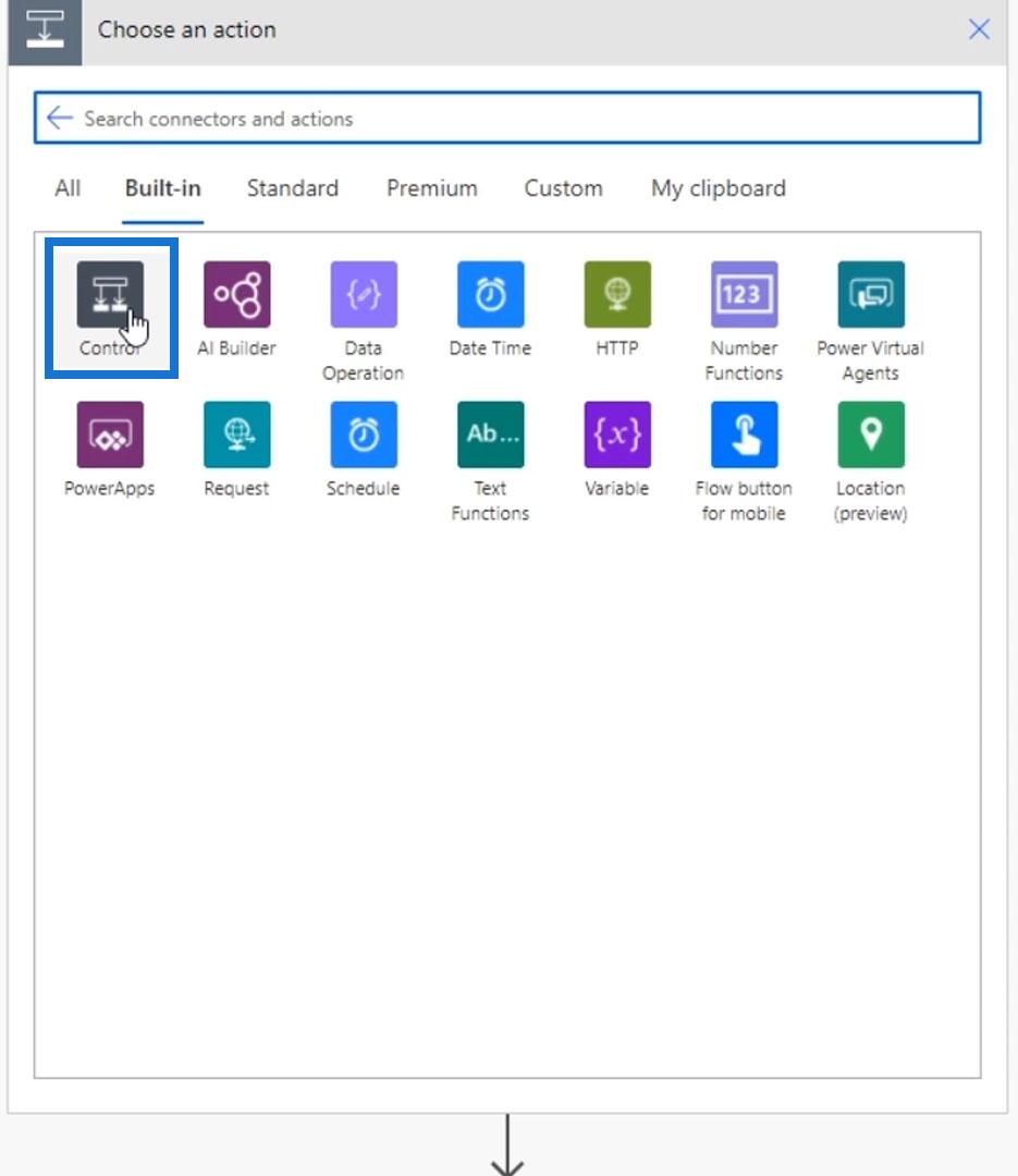

Click Control.
scope control
Then click the Scope control.

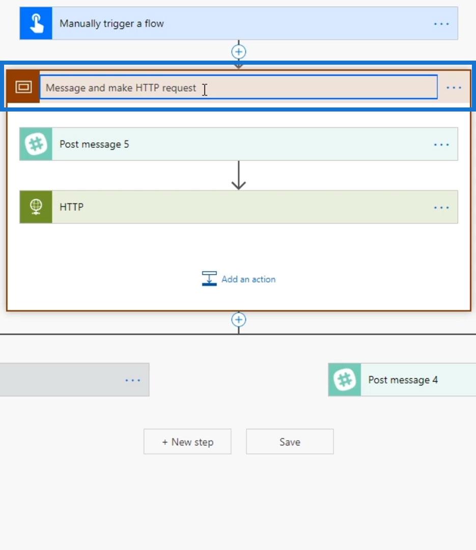

After that, drag and drop the actions that should be in a group. In this example, let’s drag both the Post message 5 and HTTP actions.
scope control
Let’s now rename the scope to “Message and make HTTP request”.
scope control
And that’s how we can easily group actions together.

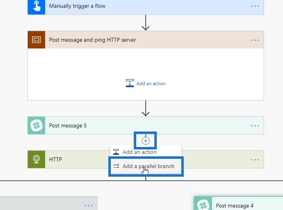

However, if the Post message 5 action fails, the flow will just stop. That’s because we didn’t set an error handler for it. What we want here is that the error notification message should still be posted whenever either of the previous two actions fails. Hence, we need to add another parallel branch for the Post message 5 action.
Search and select the Slack connector.
Click Post message.
We’ll post a message to the general channel in Slack that’s similar to what we’ve set in the Post message 4 action.

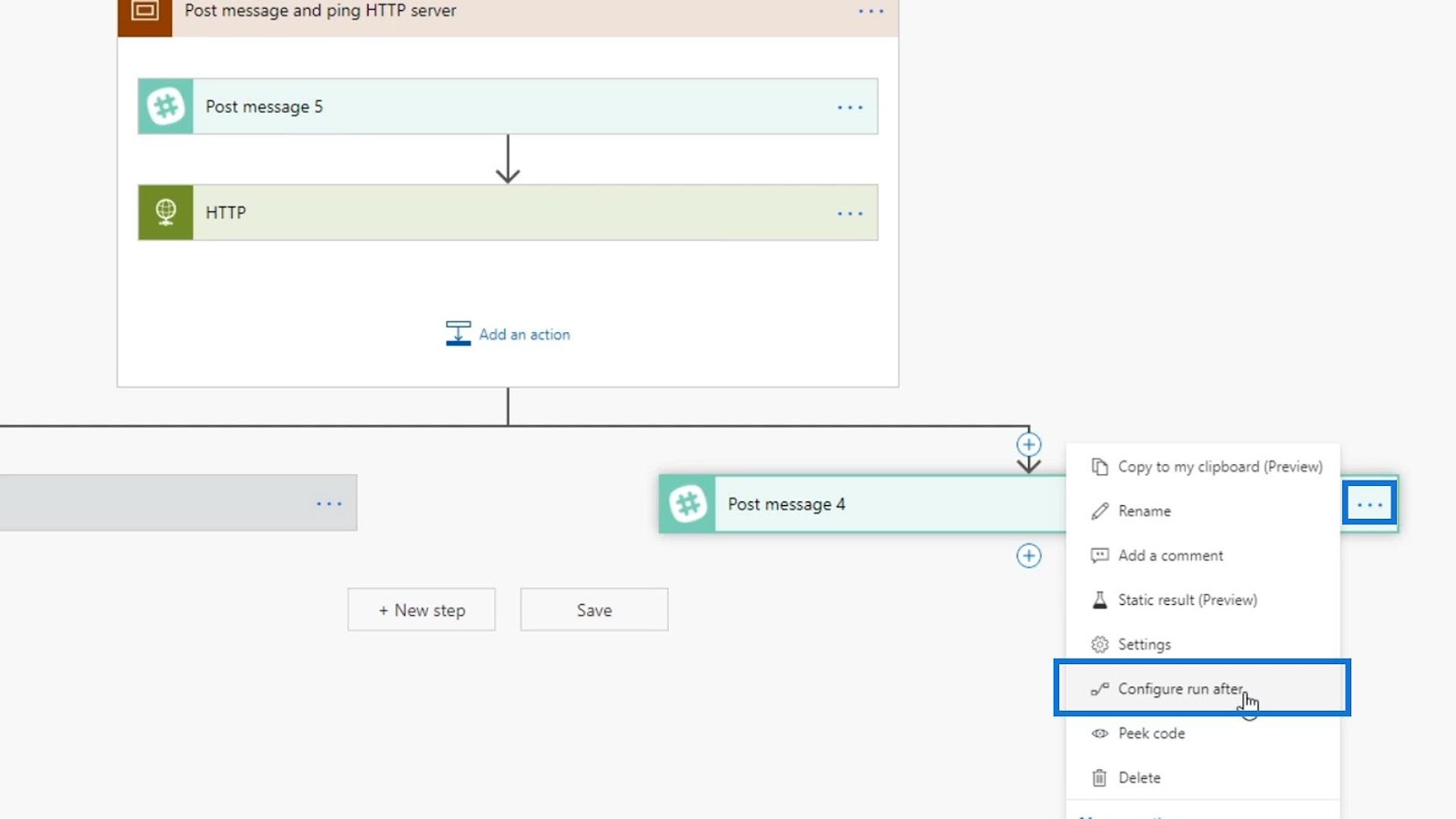

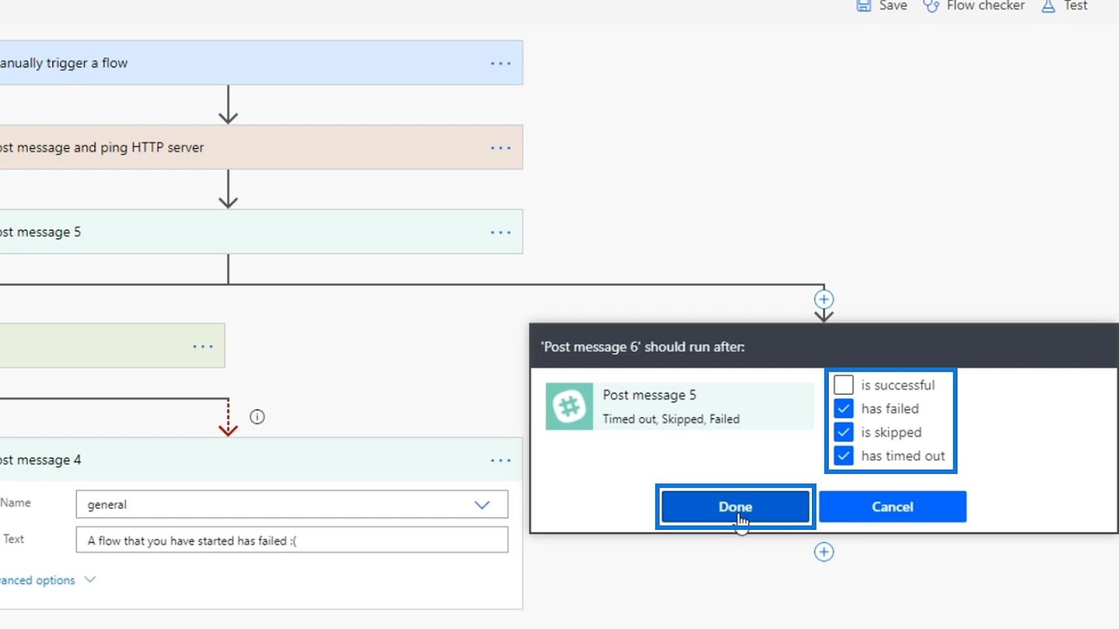

Click the three dots and click Configure run after.
Uncheck the is successful option. Then check the has failed, is skipped, and has timed out options. After that, click Done.

We need to configure this so that it’ll only run after all of the steps within the scope are complete and either of the two actions fails.
Now, we have a single error handling action that will only be triggered once any action within the Post message and ping HTTP server scope fails.
