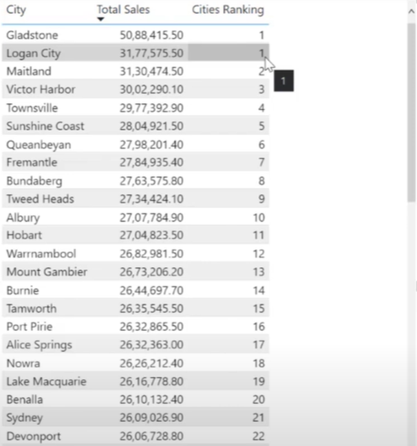

RANKX Scenario 2: Cities Ranking V1
Now, let’s apply the same approach in the first scenario. This time, however, we will apply it over the regions table where we have two cities with the same name but in two different locations.
RANKX
As you can see in the image above, inside the regions table, we have two cities with the same name, but they are available under two different territories. So what happens when we apply the same steps from our previous scenario?
The results will look something like this:
Error in results
Now we start to see a problem with our ranking formula. Since the RANKX function is iterating over an entire set of tables, it cannot consolidate the results for the cities with the same name, which are available under two different territories. This ultimately results in an error.
To solve this problem, you need to reference the field name inside the RANKX function and the table name, just like in the image below.
RANKX
So how did it fix the error? When we reference a field name inside the RANKX function, it will iterate it only through that column and not over the entire table.
It will remove the duplicates even though the two cities are available in two different territories, thereby consolidating them as one single city.
