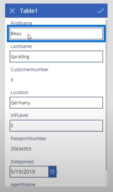

Properties are things that define the element. For example, if we look at this textbox, one of the properties might be the text box size, the actual text within the text box, the padding to the left and right, or its Y and X coordinates.
These are properties that you can change with triggers as well. For example, if you change the text, that’s a trigger. If you type a text and click enter, that’s also a trigger.

There are many different types of triggers. For example, let’s click a text box and we’ll see that it has an OnSelect trigger. It also has an OnChange trigger.
If we type a number in the FirstName field, it may trigger another action like a pop-up message saying we can’t put numbers to change it. But for now, it’ll just default to “false” because nothing happens yet.

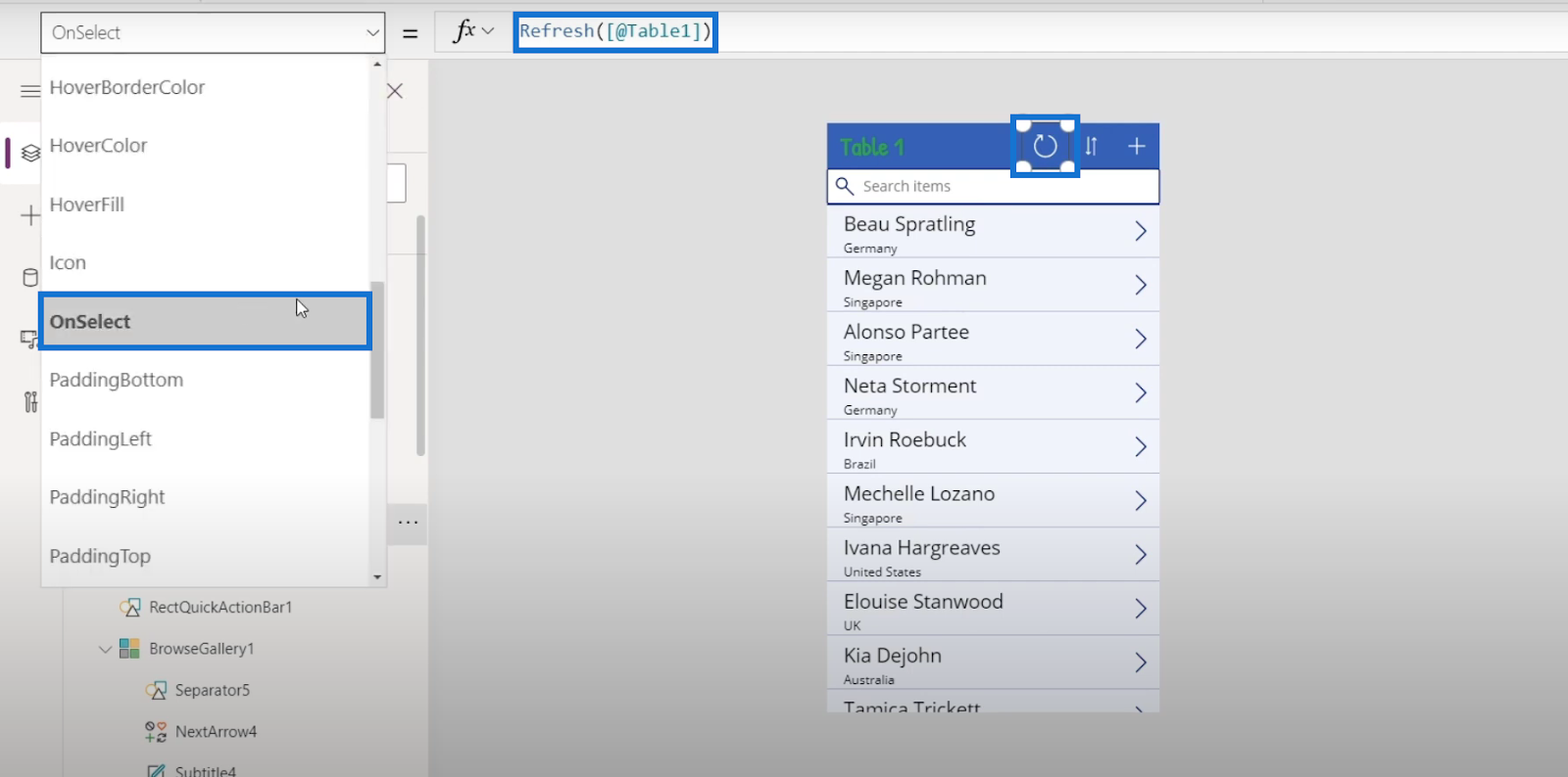

Let’s try clicking another button and see what it does. Click its OnSelect trigger. The function of this element is to refresh Table 1.

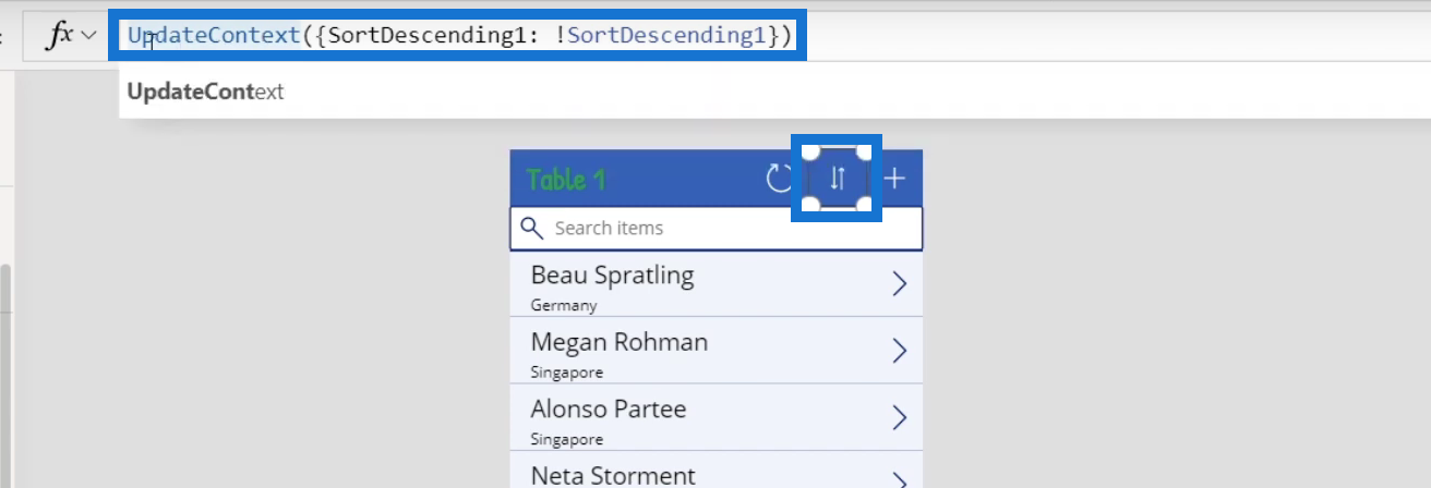

On the other hand, this button is an element that sorts data.

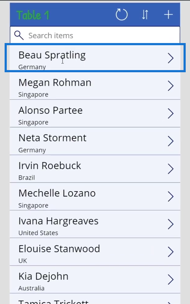

Now, let’s click the whole data card or the BrowseGallery1 to see its trigger.
PowerApps triggers
It has an OnSelect trigger as well.

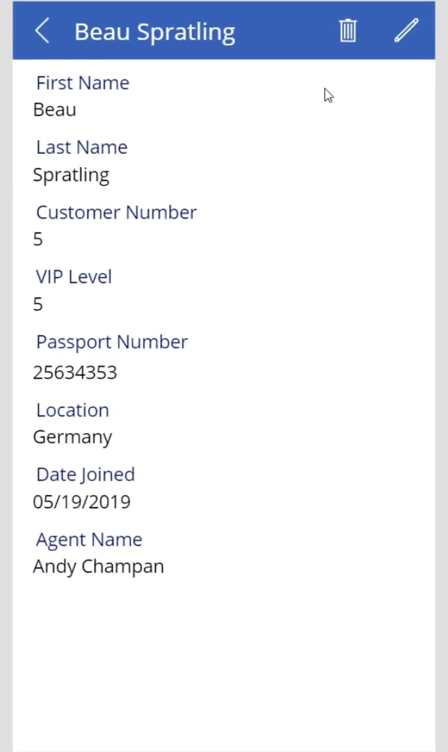

Aside from the trigger, we’ll see that the data card has the function to navigate to the detail screen.
Now, for example, let’s try changing the function of the browser gallery with the word “False” and press Enter.
After that, click the play button.
We’ll then see that the triggers are gone. Whatever we select won’t perform any action. We can still scroll the browser gallery but we can’t do anything because we removed the actual action.

Then it’ll navigate to its detail screen as it normally would.
