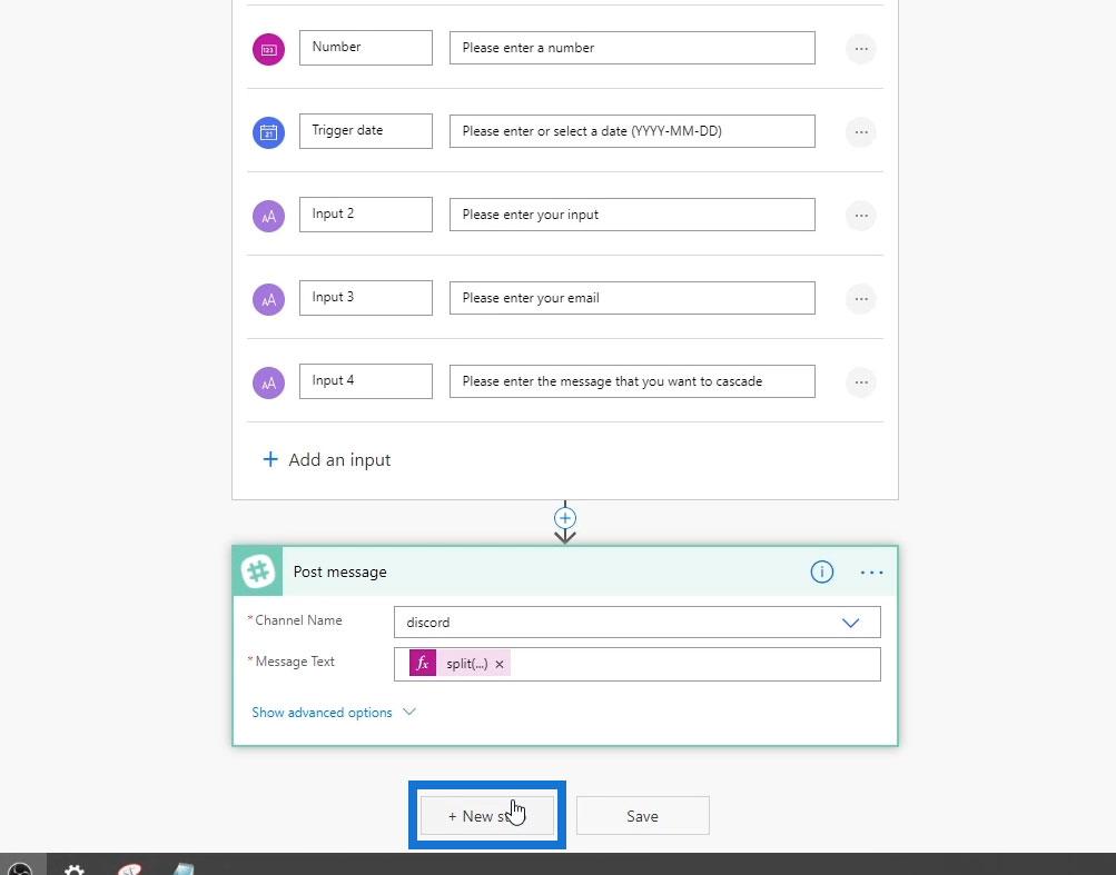

Let’s now have a sample use case to understand why we would want to do this. We’ll add another input in this sample flow that I previously created. Let’s set that as Input 4 then type in “Please enter the message that you want to cascade”.

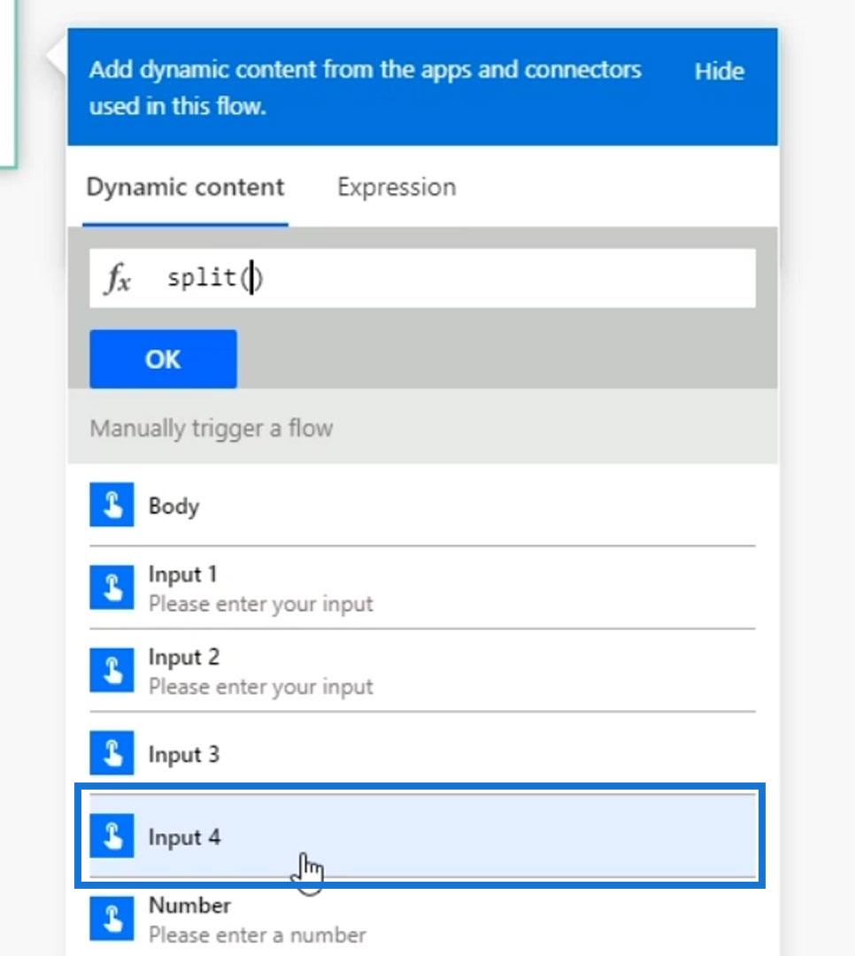

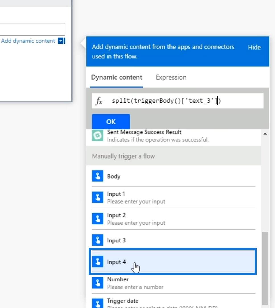

Then, let’s use the split function on our Message text. Under the Expressions tab, choose the split function.
For the text parameter, choose the Input 4 variable.
For the separator, we’re going to use a space. Then click the OK button.

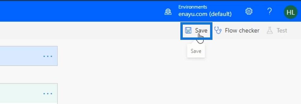

Lastly, click Save.

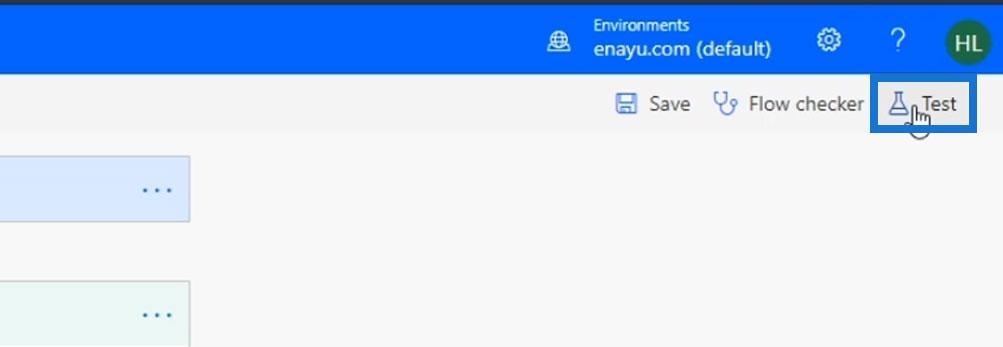

Let’s now see what happens. Click Test.
Choose the I’ll perform the trigger action option. Then click Test.

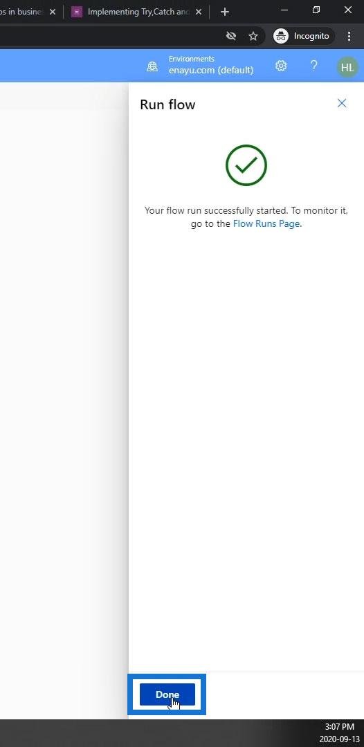

Enter any data for the other inputs. As for Input 4, just type “the apple falls far from the tree”. Then click Run flow.
Click Done.

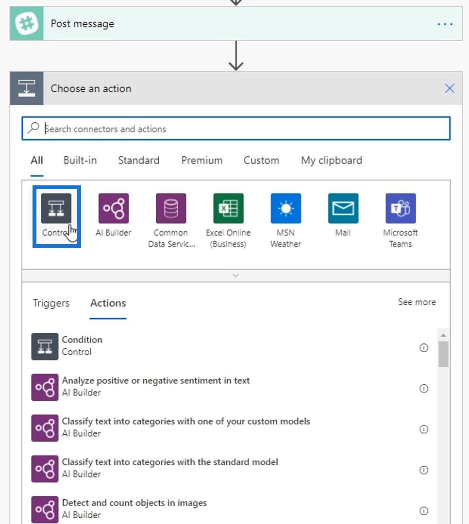

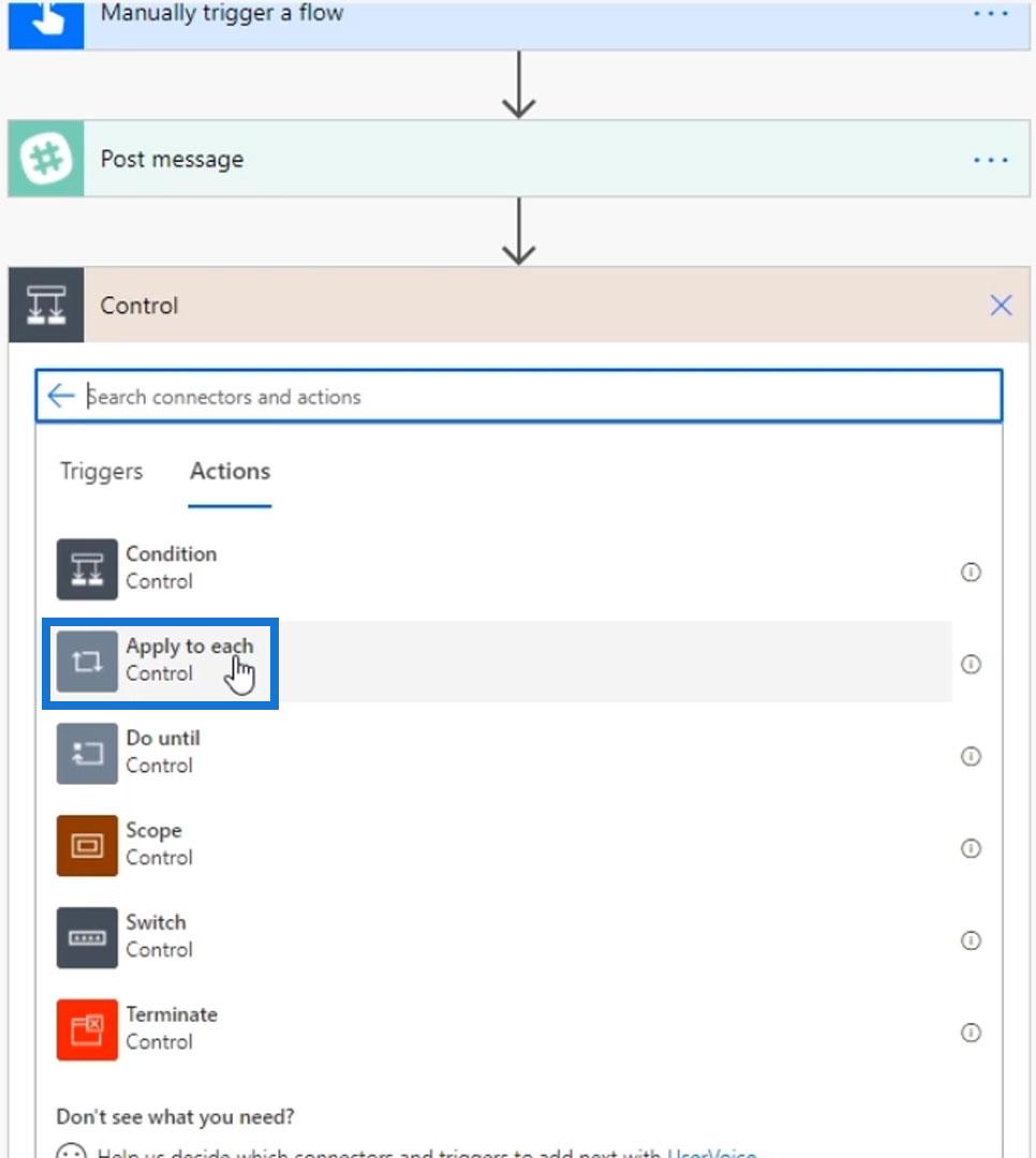

Let’s now discuss some things that you can do with an array. First, let’s add a new step.
Then click Control.
After that, choose the Apply to each control.

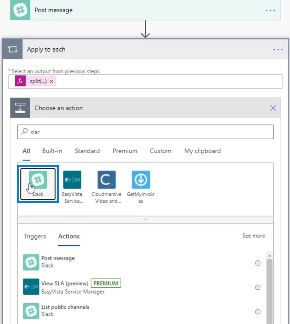

After that, let’s add another action.
Search and select the Slack connector.

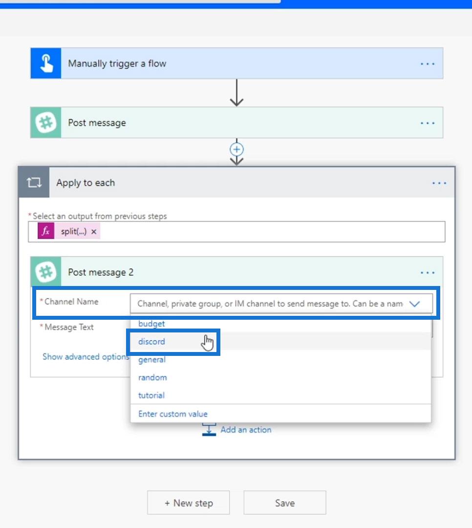

Then choose the Post message action.
Let’s post a message to the same Slack channel (discord).
For the Message text, instead of posting Input 4 or the array, we’re going to post the Current item.
By using the Apply to each control, it’s first getting the array of strings via the split function. Then, for each item in the array, it’s posting that current item. So let’s see what that looks like. Click Save.

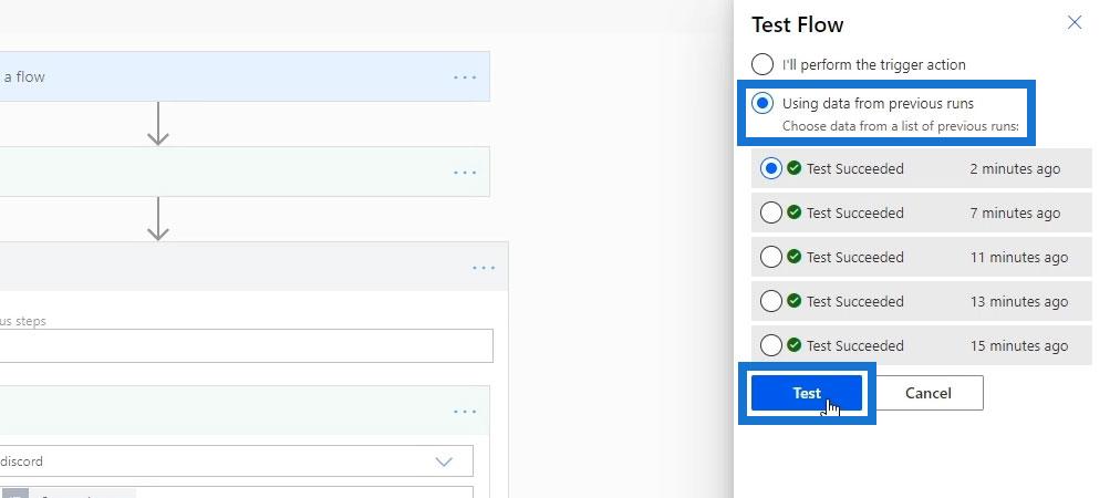

Click Test.
We’ll just use the previous run since no inputs have changed. Then click Test.
Upon checking our Slack, we’ll see that it successfully displayed each of the items from the array.
