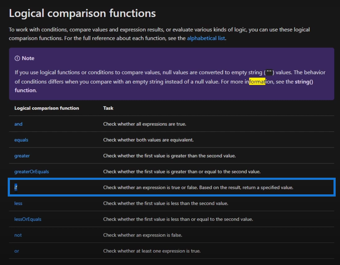

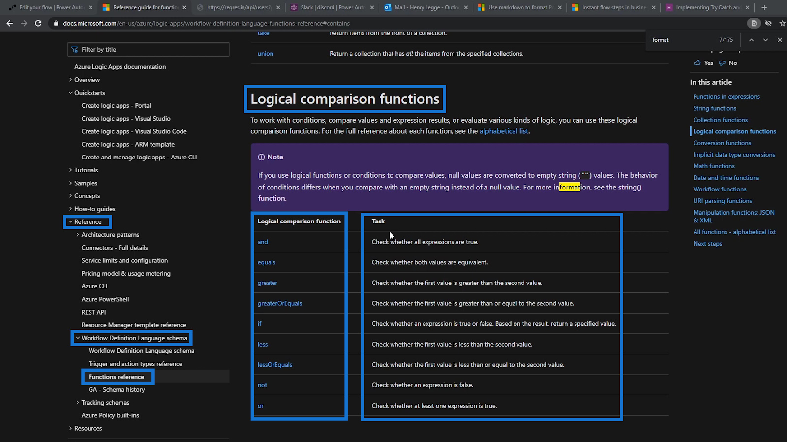

We can also get more familiar with the use of Logical Functions by looking at its documentation first. To check, go to Power Automate Documentation. Click the Reference option. Then, click the Workflow Definition Language schema topic. Lastly, choose the Functions reference subtopic. It will then display all the available logical comparison functions and each of their corresponding tasks.

First, we’ll discuss the if function. This is the most common among Power Automate logical functions because it’s similar to the if function in MS Excel or in coding. In MS workflows, this function checks whether an expression is true or false, and based on the result it will return a specified value.
By clicking it in the documentation, we’ll see the parameters and other usage-related information about the function.

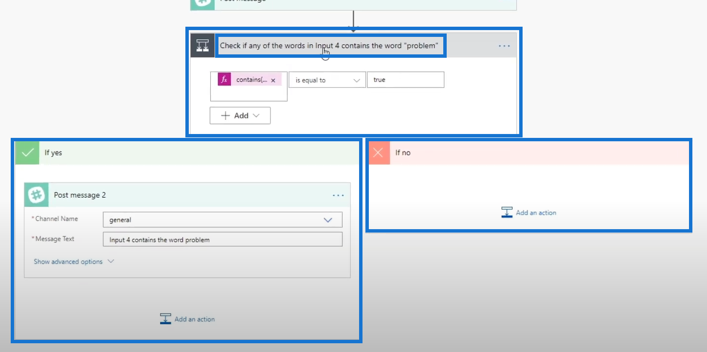

The Condition in this flow is set to check if any of the words in Input 4 contains the word “problem”. If the input from the user meets the condition, the expression becomes true. Hence, the flow will go to the If yes pathway. Otherwise, it’ll go to the If no pathway.

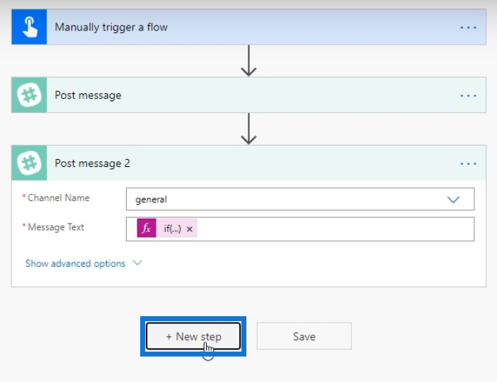

By using the If statement, we can replace the Condition control in our flow. To do that, let’s drag the Post message 2 action.
Then place it in between the Post message action and the Condition block.

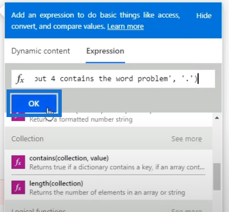

Let’s add a comma (,), a space, and type in the word “problem” enclosed in single quotation marks (). Then add a closing bracket ()), another comma (,), and a space after that.
So, if there is an element containing the word “problem”, it’ll return true. If not, it’ll return false. If it returns true, we’d like the message to be “Input 4 contains the word problem”. To do this, let’s type the text “Input 4 contains the word problem” at the end of the statement.
If it returns false, we’d like the message to be just a period (.). To do this, let’s add a comma (,) right after the closing quotation mark of the word ”problem”. Add a space, then type the period (.) enclosed in single quotation marks ().
After that, click OK.

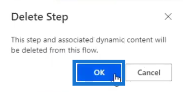

Let’s also delete the Condition block.
Then click OK.
Lastly, click Save.

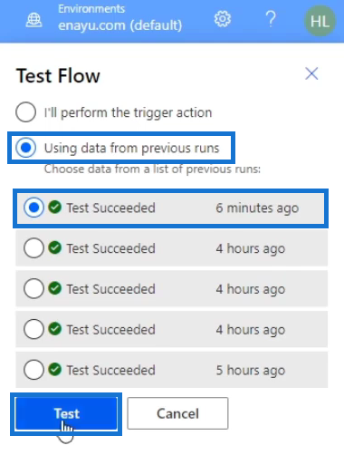

Let’s now test the flow and see how it works.
Let’s run this using the same data during our previous run. Then, click Test.
After that, we’ll see the result of our successful flow run.

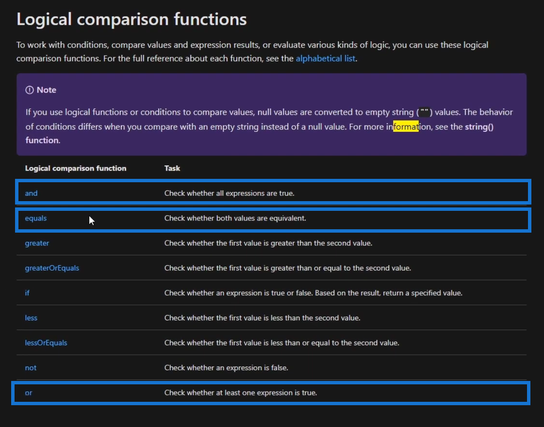

Other Power Automate Logical Functions
There are 3 other logical comparison functions we’ll go through which are also heavily used—the and, equals, and or functions.

1. Power Automate Logical Functions: Equals

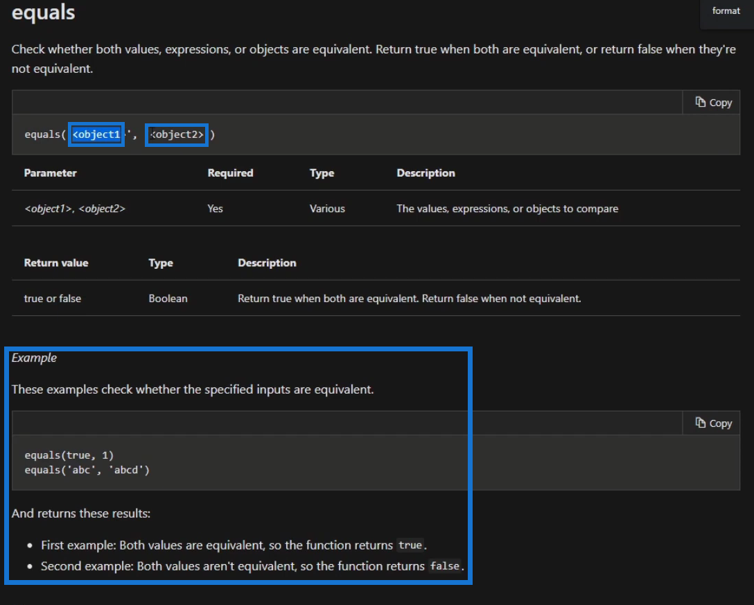

Let’s check the equals function
This function is fairly simple and we’ve already used this in previous tutorials. It evaluates two objects which can either be strings, integers, collections, arrays, or others. If the values of the two objects are equal, it’ll return true; and if they’re not, it’ll return false. An example is provided in the documentation as well.

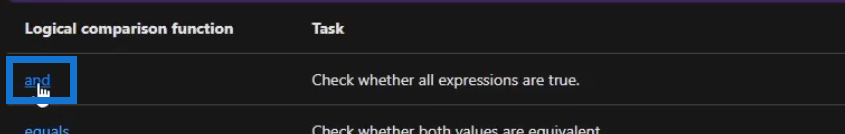

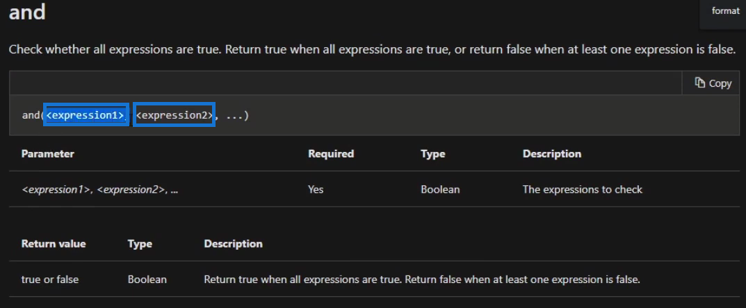

2. Power Automate Logical Functions: And
Next is the and function.
This function can be easily used if we have multiple expressions to evaluate. We just put in multiple expressions and they’ll return true if every single expression is true.

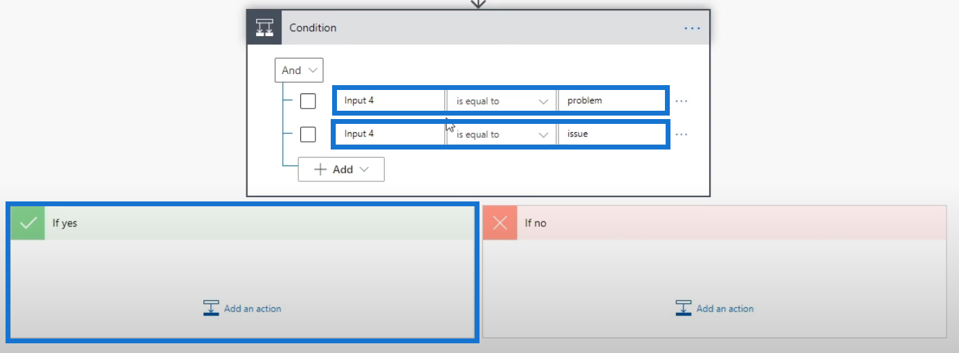

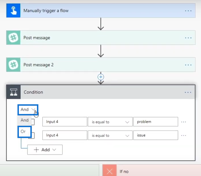

For example, let’s go and edit our flow.

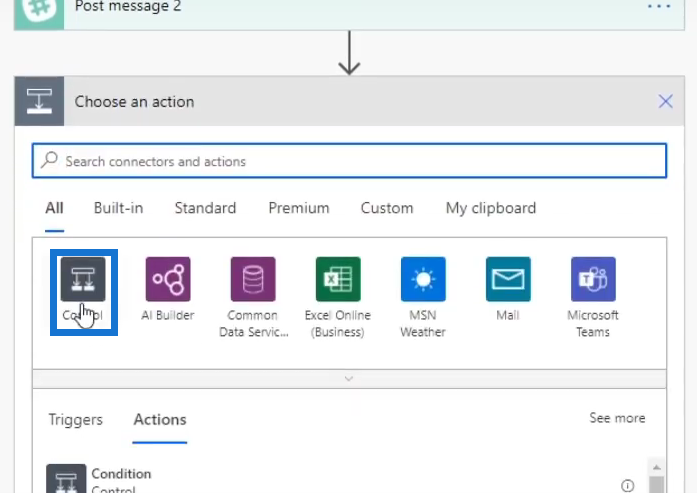

Click New step.

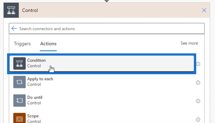

Let’s click the Control connector.
Then, click Condition.

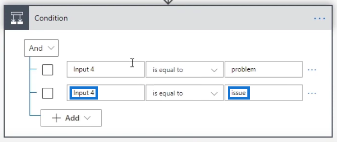

We’ll set the condition to “Input 4 is equal to problem”.
After that, click Add then click Add row.
In the additional row, we’ll set the condition to “Input 4 is equal to issue”.
Whatever we input here won’t work because we need to use the Input 4 variable (a dynamic content) instead of just typing Input 4 as strings. But this is only to show you how it looks, which is similar to using the and function in an expression.
In this example, the flow is going to check if the Input 4 is equal to “problem” and if it’s also equal to “issue”. Hence, if both expressions return true, it’ll go down the If yes pathway.
3. Power Automate Logical Functions: Or
The last one we’ll look at is the or function.
The or function is very similar to the and function. The big difference is that for this function to return true, only one of the expressions needs to be true.

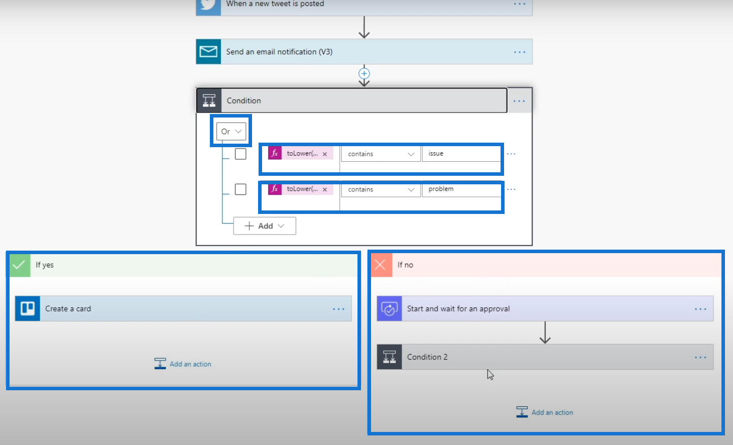

For example, let’s go back to our flow. Then, click the And button and choose the Or option.

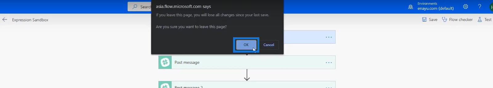

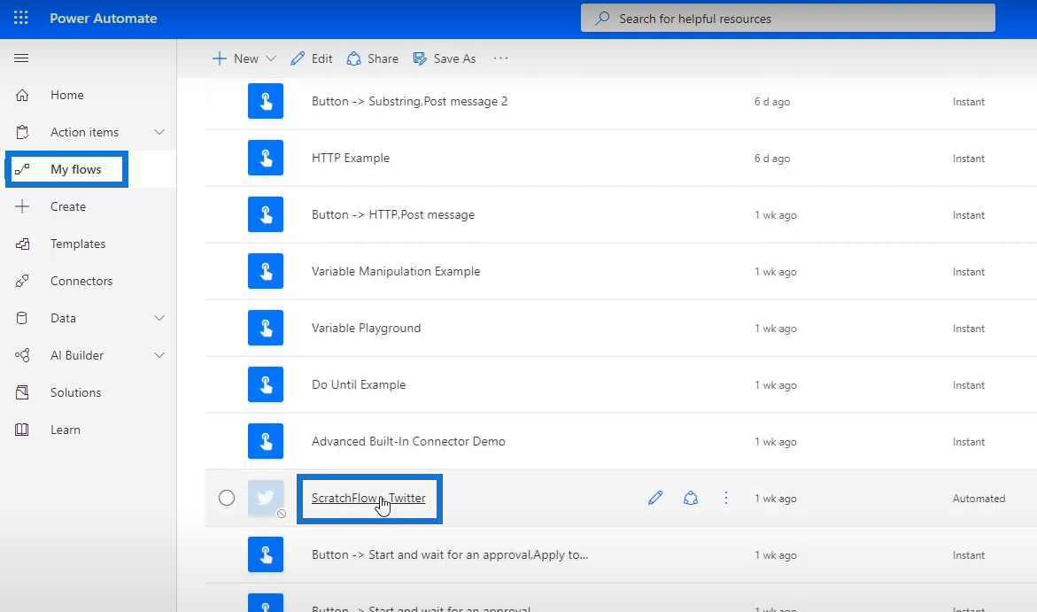

I’ve already used this in one of my previous flows. Let’s check that out by clicking the back arrow at the top.
Then click OK.
After that, click My flows and click ScratchFlow – Twitter from the list.
Click Edit.
Click the Condition block.
Then, we’ll see that the or function was used in this previous flow. In this example, it evaluates if the tweet contains the word “issue”, or “problem”. If one of these two conditions is true, it’ll perform the action within the If yes pathway which creates a Trello card. If both are false, it’ll do the action that we set for the If no pathway.
