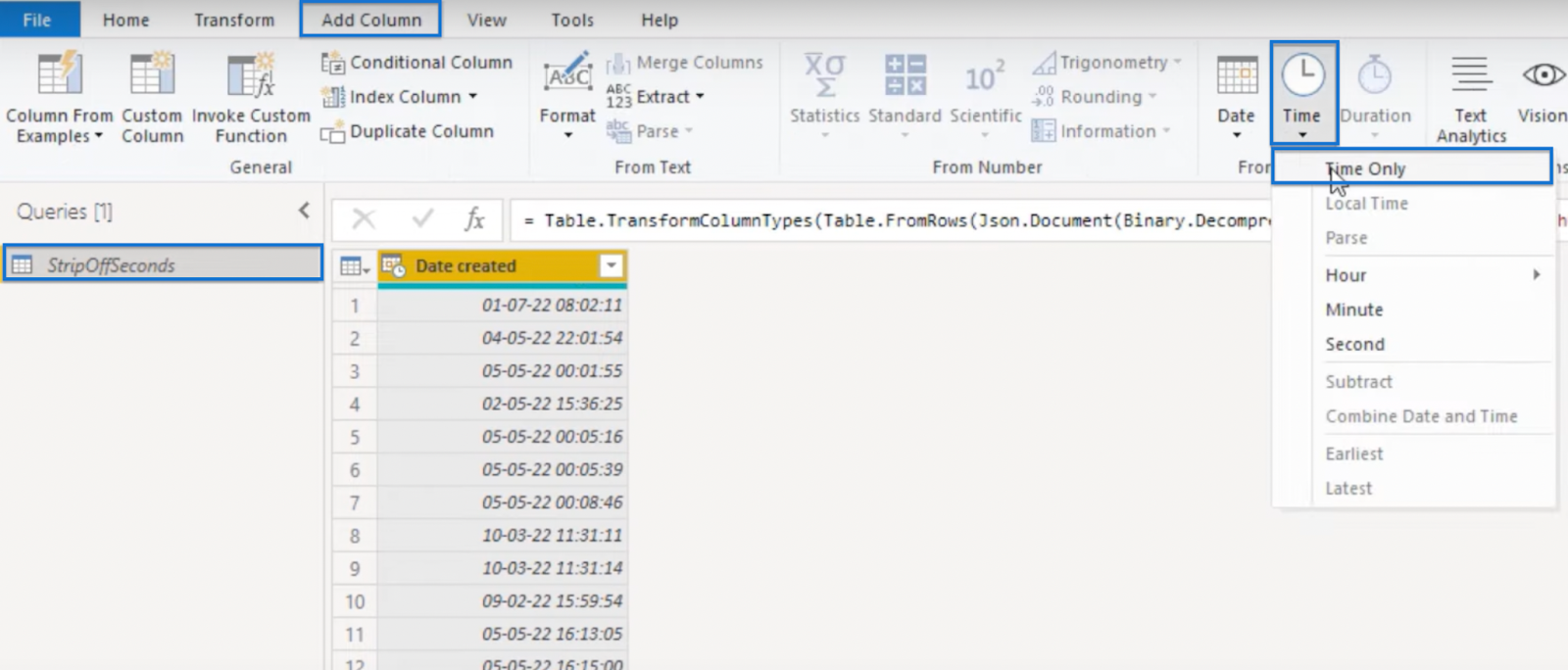

Start by going to your Power Query editor. The first approach that you will be learning is a full user-interface-driven approach.
With your DateTime column selected, go to the Add Column tab, select Time, then choose Time Only.
Full UI-Drive Approach for DateTime Values
A Time Column will show up.

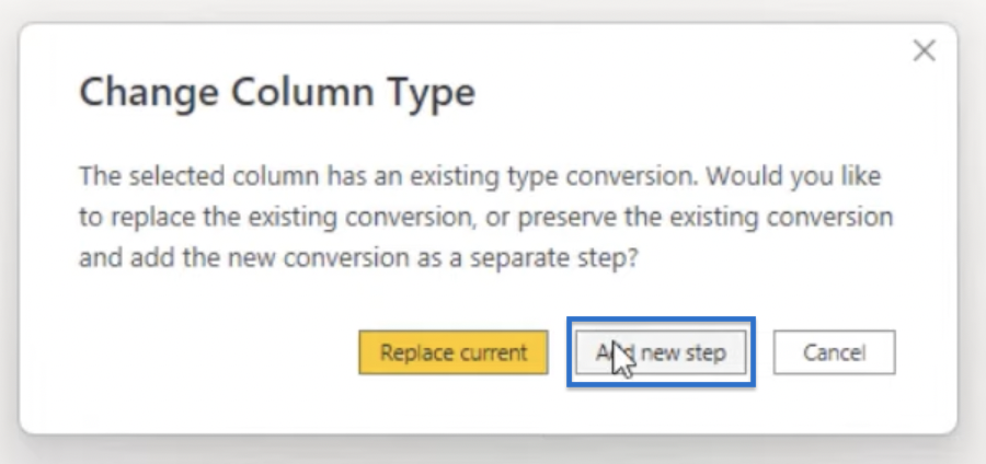

Click the Time icon and choose Text.
Then, revert it back to Time by following the same steps. Don’t select replace current, but Add New Step instead.
And now we’ve lost the seconds of that time value.

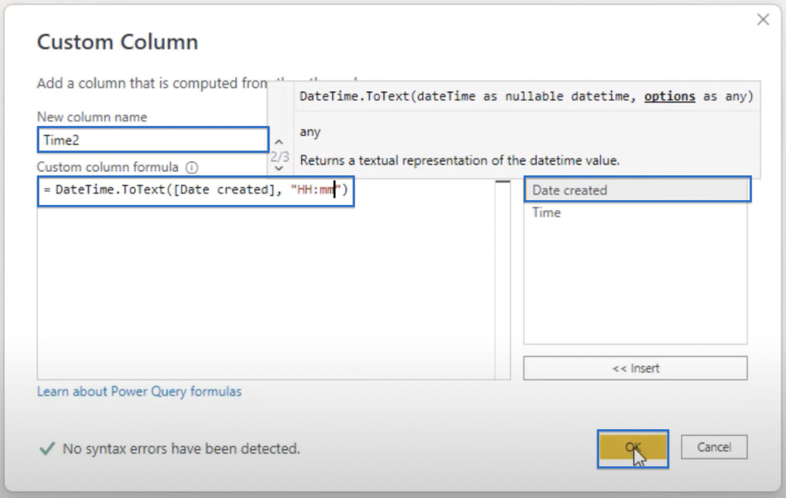

With the Mini Table Icon in the upper left corner, select Add Custom Column
The Non-UI-Driven Approach

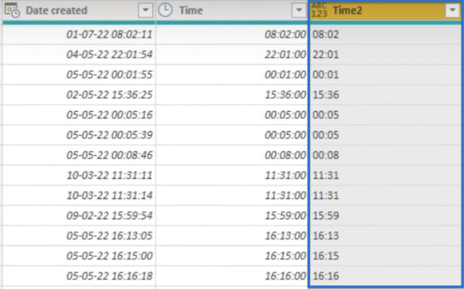

You can call the new column Time2. To convert a DateTime value into text, you can use the function =DateTime.ToText ([Date created), “HH:mm”).
Note that the Date Created part in the function is added by clicking on the Date Created column on the right as shown in the image above. The HH:mm shows the time format, and we use capital HH to apply the 24-hour format.

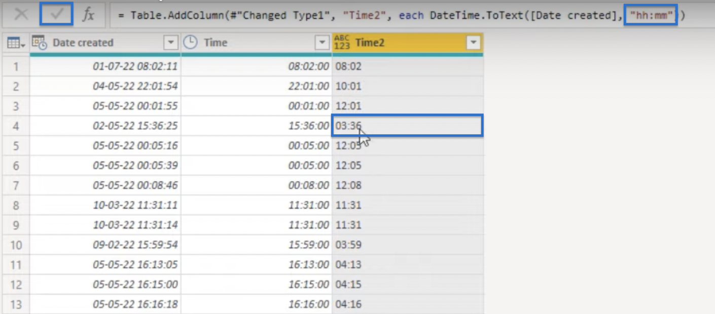

Let’s click Okay. From the results, we can see a new column with the hour and minute only.
Let’s also try changing the hour format to lowercase. To do that, go to the formula bar and change HH to hh. Click the check mark afterward.
For the purpose of this blog, let’s revert our table back to the 24-hour format by changing it back to HH

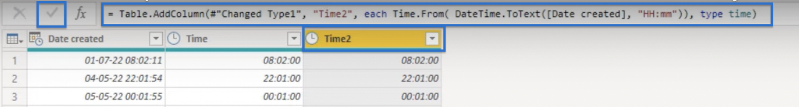

The time values you have are in the text format. To revert them back to the time format, use the function shown below and click the check mark.

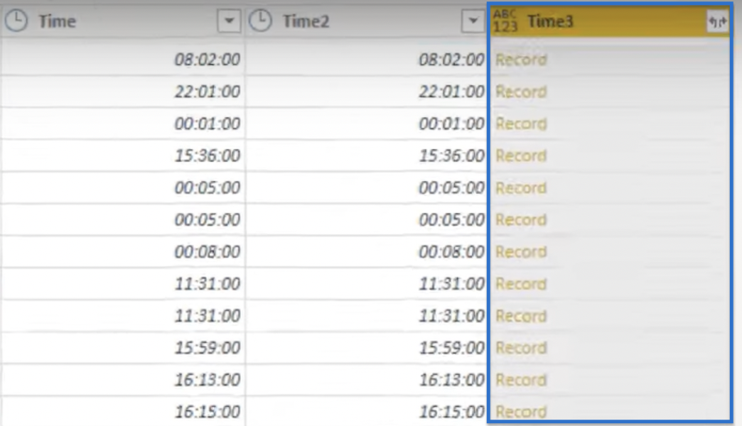

Click OK to return the record.
Using DateTime Value Record
Click on one of the records, and you should see a preview down below.
In the preview, you can see that the date and time parts get a field inside the record.

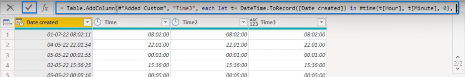

Using the intrinsic #time function, you can turn that back into a time value. First, create a variable to refer to it more easily. So let t equal the function you already created with the intrinsic time value added. It takes three arguments–the hour, the minutes, and the seconds.
Extend the function by adding an opening parenthesis. For the hour, call your record t and refer to the field name hour by typing hour inside square brackets like this: t[hour].
Add comma (,), then repeat the same steps for the minute: t[Minute]. Add another comma and zero (0) for the seconds.
The resulting function is shown below. Then click the check mark.
Of course, you can also set the type by adding type time to the function.
