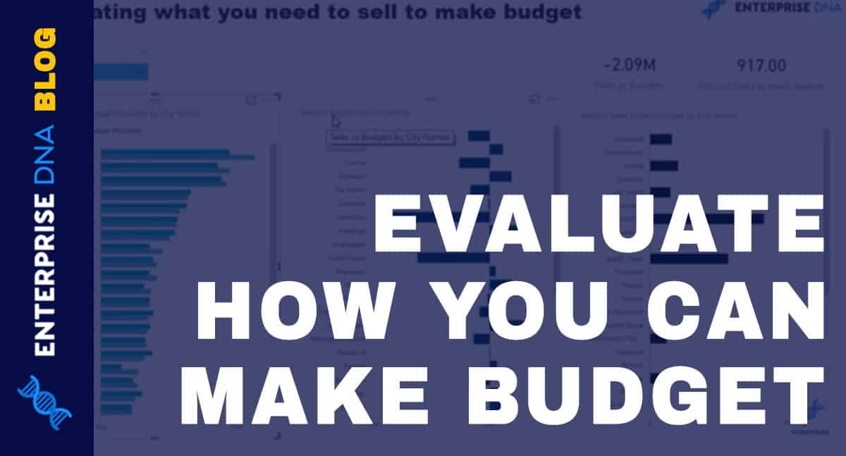

Evaluating What To Sell To Make Budget
Let’s take a look at this piece of analysis where we can evaluate what we need to sell to make budget. For the first chart, I have the Total Sales and the Budget Allocation for each different city.
The second chart shows what our sales were versus budget so we can quickly see all the negatives, which are the ones that are behind budget obviously. The measure we used to come up with this chart is Total Sales minus Budget Allocation. We need to figure out how much we need to sell in this particular region to make budget.
Now, we have to make a few assumptions here so that it could be extended in a number of different ways. I’ve made some assumptions to simplify things a little bit but what we want to work out is how much we need to sell. If we just think logically, we’ll know how to use all these negative numbers from our Sales vs Budgets chart and divide it by the average sale price of anything sold in these regions. This will get us to where we want.
Product Sales To Reach Budget
So we came up with a measure that says if the Sales vs Budgets is less than 0, then we want to go Sales vs Budgets multiplied by -1 to give it a positive number. Then we will divide it by the average sale price within that particular region. This measure will tell us how many products on average we need to sell in that particular region to get us to budget.
