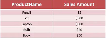

Let’s assume that we have the ProductName and Sales Amount columns.
ISNULL SQL

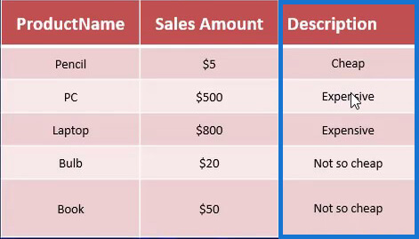

Then we want to create an additional column named Description.
ISNULL SQL

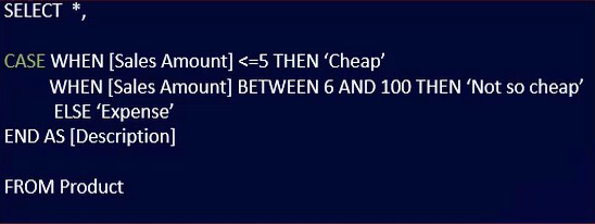

We also want to add logical statements that’ll display ‘Cheap’ if the Sales Amount is less than or equal to 5, then ‘Not so cheap’ for between 6 and 100. If the value is greater than a hundred, it will display ‘Expensive’.
ISNULL SQL
In this example, we used the SELECT statement to select the column that we want to view. After that, we have the CASE statement that contains the logical operations we mentioned earlier.
In utilizing the CASE statement, the WHEN and THEN statements are always used to indicate the logical operations that we want to implement in the selected column. The ELSE statement is for setting a default value if the logical operations set were not met.
At the end of the CASE statement, we have END AS and the column name next to it. This will create a new column named Description with values based on the logical operations that we’ve added in the CASE statement.

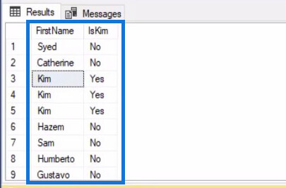

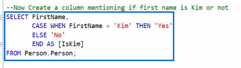

Let’s begin by selecting the FirstName column from Person.Person. Take note that in this example, it’s not necessary to select a column. This is just for your reference.
After bringing up this column, let’s create a column that will display values whether the first name is Kim or not by using the CASE statement. To do that, simply follow the example below.
In the sample code above, we added a condition using the CASE statement where if the FirstName is equal to ‘Kim,’ it will display ‘Yes’ and if not, then it’ll display ‘No’ instead.
For this example, I also created a new column named ‘IsKim’ using the END AS function. See the example below for the result.

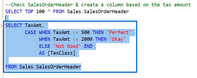

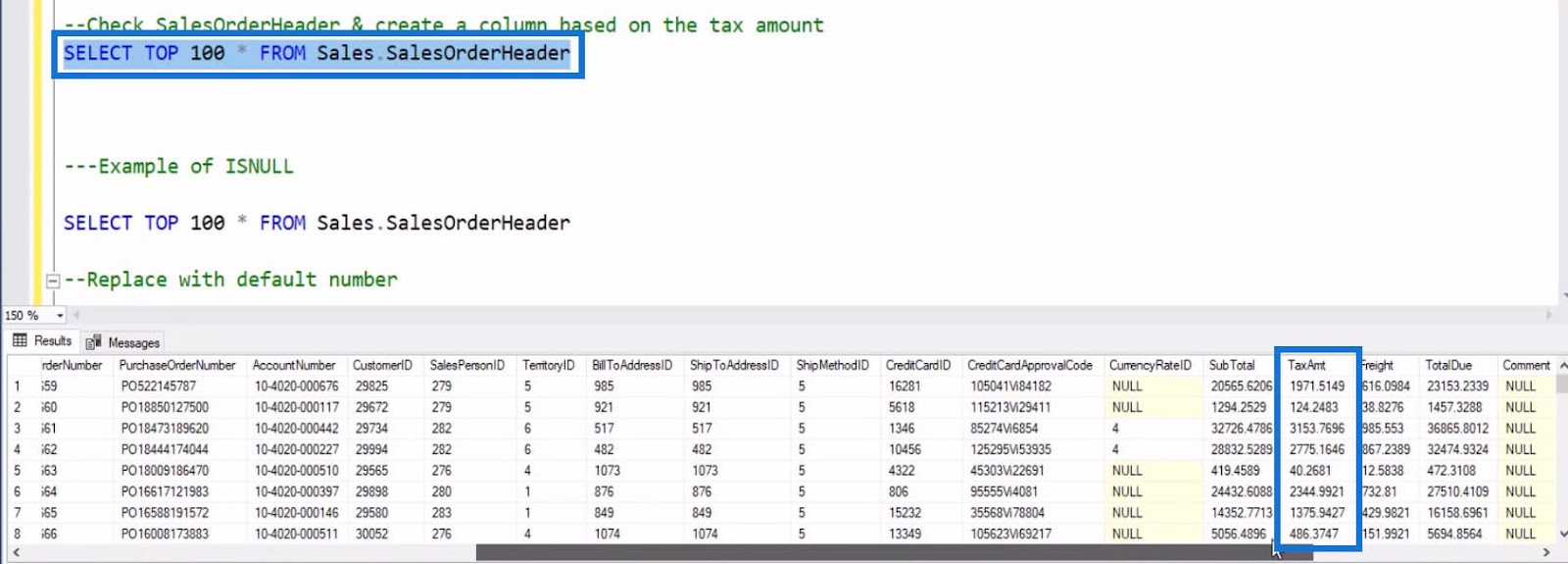

Now let’s have another example using the CASE statement by applying some conditions on the TaxAmt column from the Sales.SalesOrderHeader table.
First, let’s bring the top 100 columns from Sales.SalesOrderHeader using the following line of code and look for the TaxAmt column.
After that, let’s start applying conditions for the TaxAmt column with the CASE statement using the example below.
Similar to the previous example, we started by selecting the column that we want to apply our conditions to – in this case, it’s the TaxAmt column.
Then in the CASE statement, we added conditions where if the TaxAmt is less than or equal to 500, then it will display the value ‘Perfect.’ If the TaxAmt is less than or equal to 2000, then the value ‘Okay’ will be displayed.
Additionally, if the conditions were not met, the ‘Not Good value will be displayed. At the end of the statement, I created a new column named TaxClass.
That’s how we utilize the CASE statement in SQL. Take note that you can set as many conditions as you like. Just make sure to use the WHEN and THEN statements as well as the END AS function to generate a new column where the results will be displayed.
