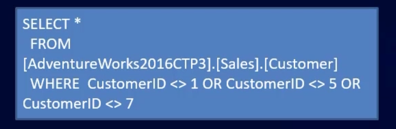

In this example, we’ll be getting the data from IDs 1, 5 or 7. Most people would use OR conditions.
filter in SQL
If you want to get the data from more IDs, you’ll have to write multiple OR conditions. However, you can use the IN operator to get the data you want instead of using OR conditions many times.
filter in SQL
Using this filtering condition will give us the same output, which is the data from IDs 1, 5 or 7. On the contrary, if you want to extract the data from all except from the IDs 1, 5, and 7, you would most likely use the OR condition and <> (NOT EQUAL operator).

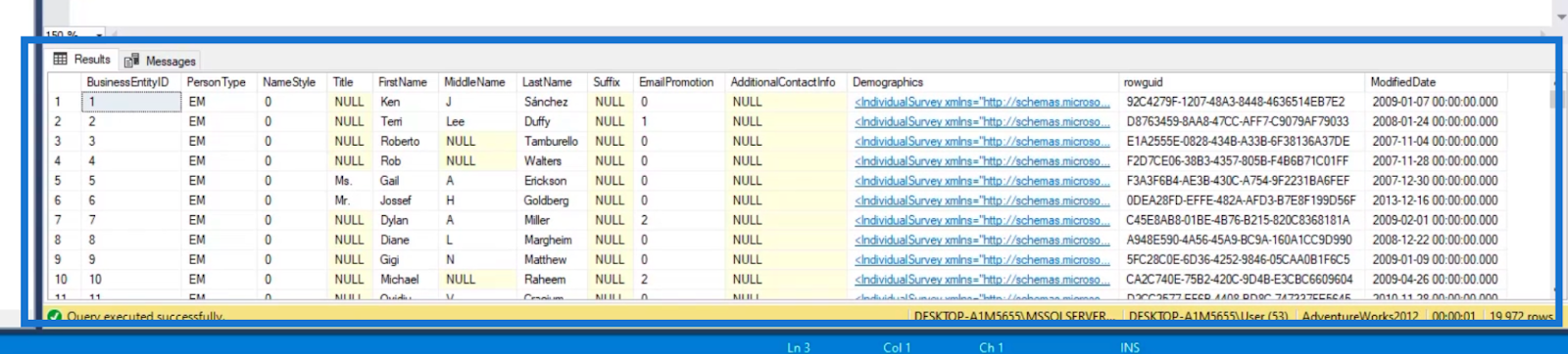

Next, we’ll load the table that we’ll be using. Take note that the database that we’re using is adventureworks2012, which can be found on the Microsoft Documentation website.
filter in SQL
Then, click Execute.
filter in SQL
After that, you’ll see the output on the Results tab.

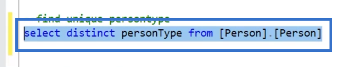

Then, we’ll filter the output based on PersonType. We’ll use the select distinct command. We’ll highlight the command and click Execute.
Then you’ll see the output showing the PersonType.

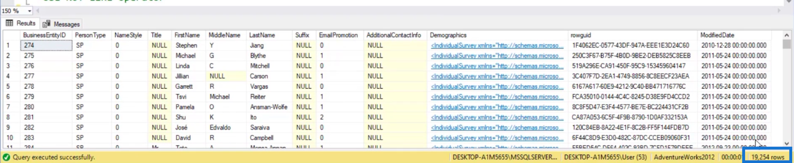

Next, we’ll extract the records from PersonType IN, or SP, or SC. For this one, we’ll use the OR condition. We’ll highlight the command, and click execute.
You’ll then see that the number of rows is 19,254.

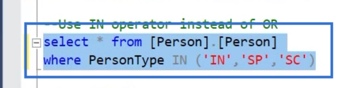

However, instead of using the OR condition, we’ll use the IN operator. So, we’ll type the command and highlight it. Then click execute.
This will give us the same number of rows, which is 19,254.

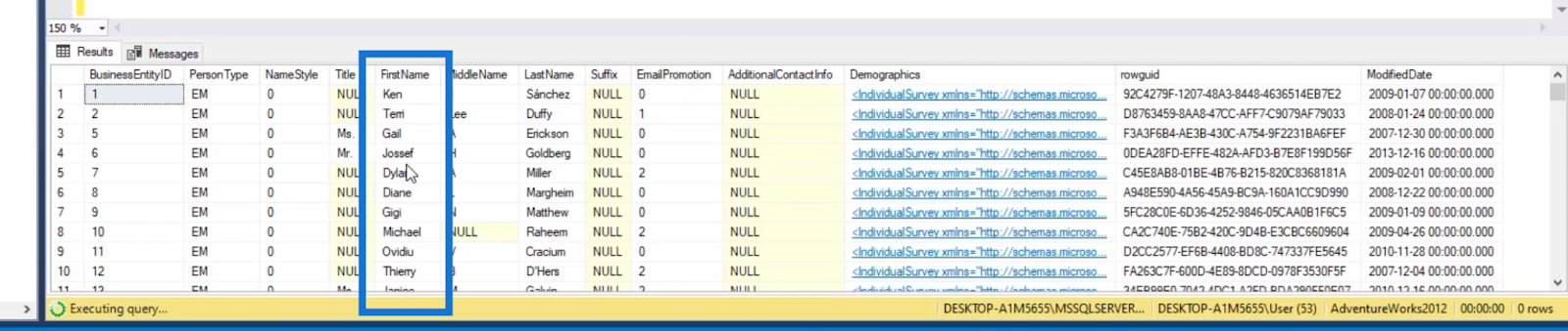

Next, we’ll use the LIKE operator to extract the data that contains Rob from the FirstName column. Let’s use the command, highlight it, and click Execute.
As a result, we’ll see that the output now contains Rob in the FirstName column. Since we used the %, it will show all data that have the string Rob.
