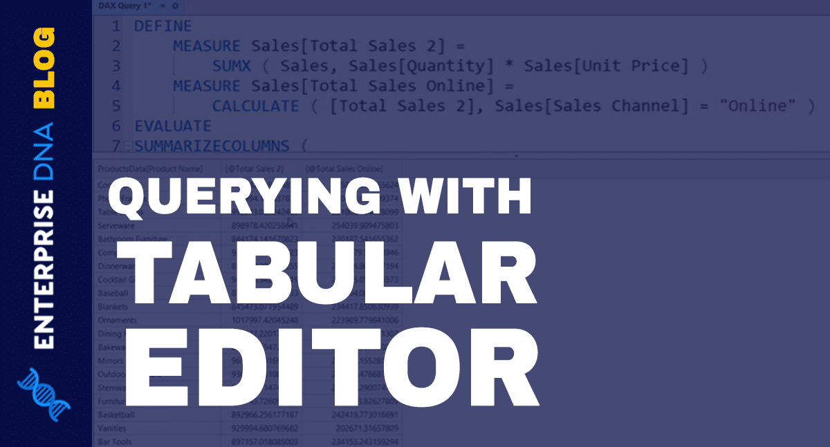

Tabular Editor has a feature that allows you to create queries for local sessions. To create a DAX query, go to the File toolbar. Click New and then select DAX Query. With that, you can now create measures that are local to the query.
First, input DEFINE and then MEASURE. Next, specify the table where you want to create the measure and name it Total Sales 2. Provide the code for the Total Sales measure by using the SUMX function. Input the Sales table as the first argument and input Quantity multiplied by the Unit Price as the second argument.
Next, define another measure and name it Total Sales Online. Use CALCULATE and input Total Sales 2 as its first argument. Then, input Sales Channel as a filter in the second argument.
To return a result, use the EVALUATE function. Inside that function, use SUMMARIZECOLUMNS for the Product Name, Total Sales 2, and Total Sales Online.
DAX Coding
You can see that two measures are created. These measures are local to the query and don’t appear in the TOM Explorer and Power BI. After formatting the code, this is what it will look like.
DAX Coding
From there, run the code by pressing F5. After that, you’ll see a table with the Product Name, Total Sales 2, and Total Sales Online columns.
