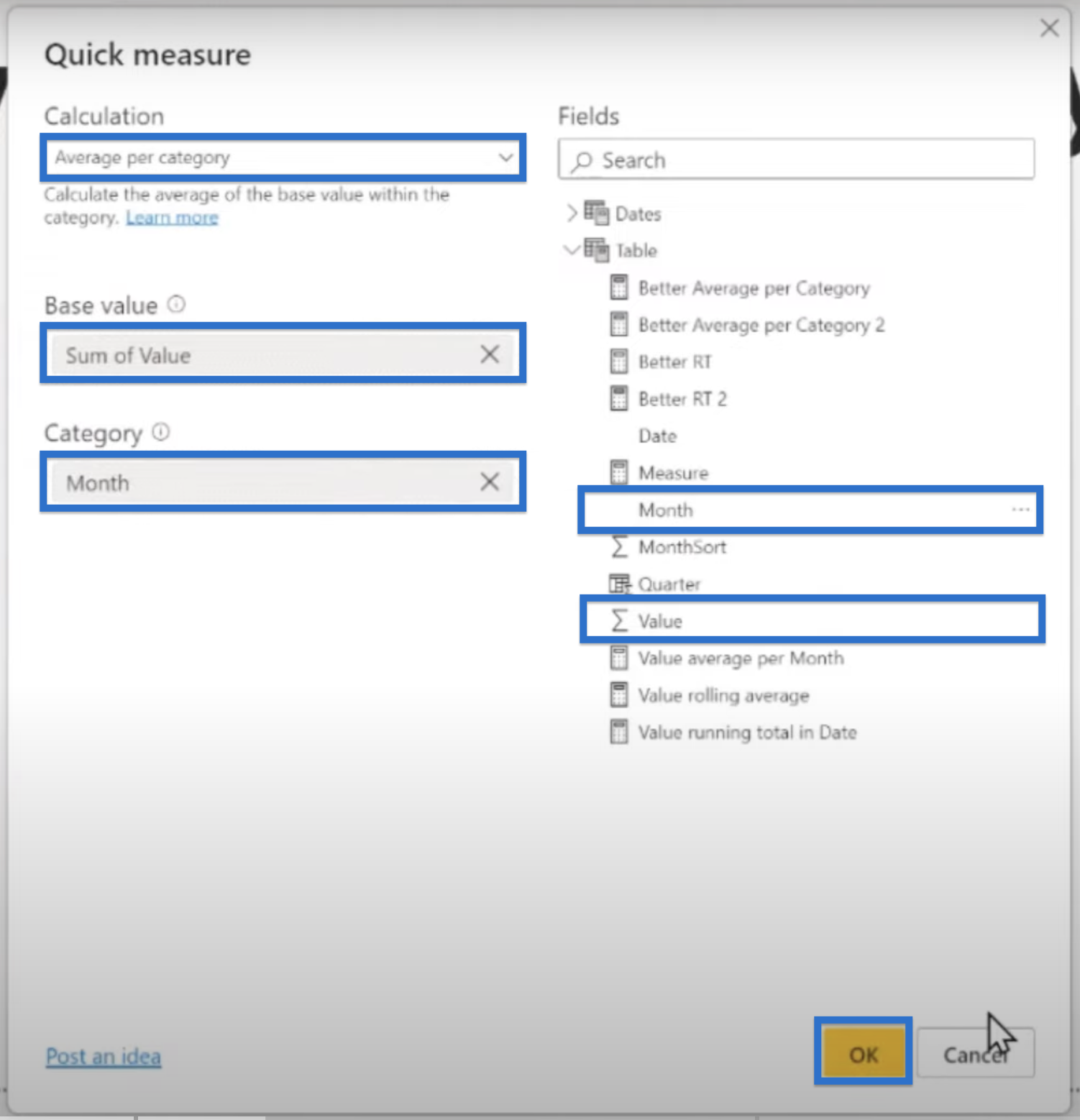

This blog will delve on a quick measure called Average Per Category. If you are in Power BI desktop, start by going to the Fields pane and creating a New quick measure.
In the Quick Measure window that will pop-up, choose Average per category in the Calculation dropdown. Then, drag ? Value in the Base Value text field, and Month in the Category field.

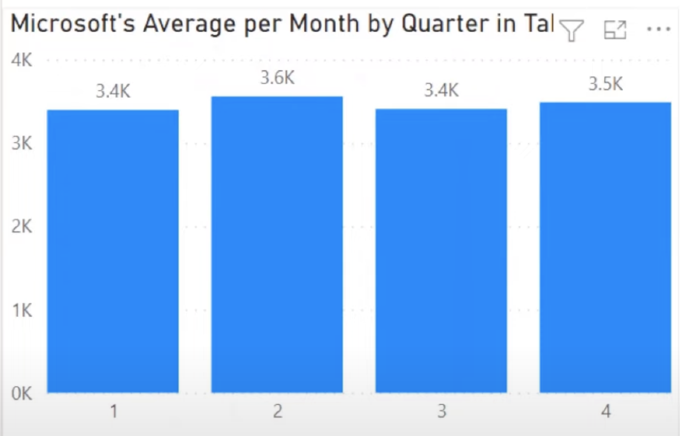

Then click OK and you’ll get a visual that looks like this.
CALCULATE In DAX Formula
In the x-axis are the quarters—Quarter 1, 2, 3, and 4.
And what you want to do is sum up the values for every month shown below and then take the average across those values. In short, the Average Per Category, which is the topic of our blog.

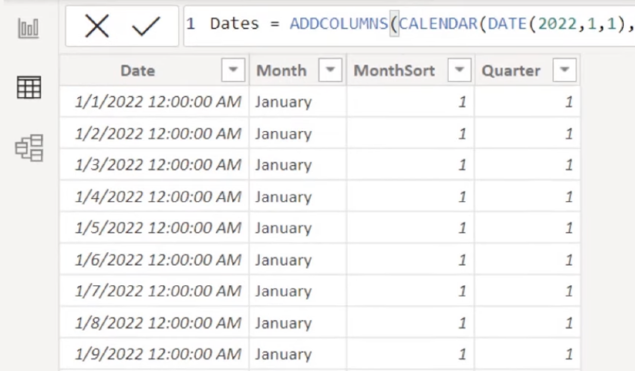

Our data model for this is very simple. We have a table with Dates, Values that are randomly generated, and Month, MonthSort, and Quarters in separate columns.
And we have the same thing in our date table with the Calendar Table, Month, MonthSort, and Quarter. This means we can choose the Quarter or Month from either the date table or the first table.

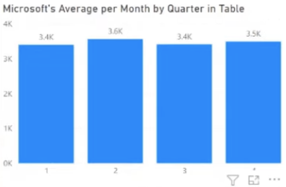

In these visuals, we’re using the Quarter from the first table…

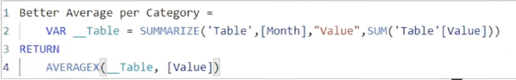

First, create a table variable using VAR_Table. Then, we’ll use SUMMARIZE to take the Table, summarize it by Month, create a Value column, and sum up our values.
Finally, we’ll take the average of our values using the AVERAGEX function.
Using The SUMMARIZE Function
This code is simpler and is so much more logical. It doesn’t include CALCULATE, which you don’t need anyway.

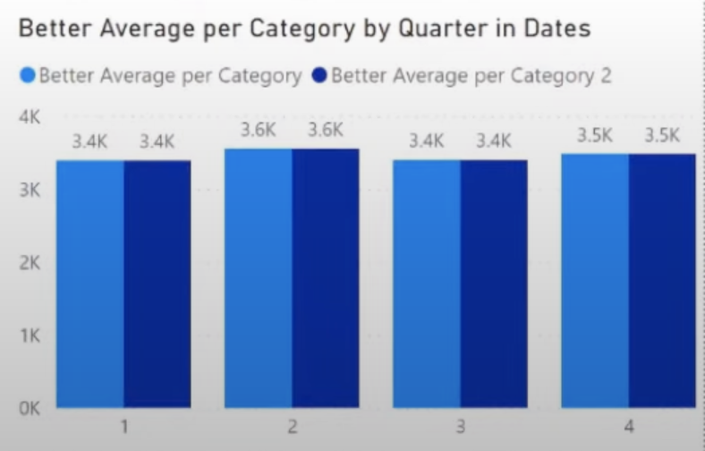

As you can see in the images below, both SUMMARIZE labeled as Better Average Per Category and GROUPBY labeled as Better Average Per Category 2 return the same numbers.
Comparing The Results
Both of our formulas return 3.4K for Q1, 3.6K for Q2, 3.4K for Q3, and 3.5K for Q4. And again, they work in a single table data model using Quarters for our table.
