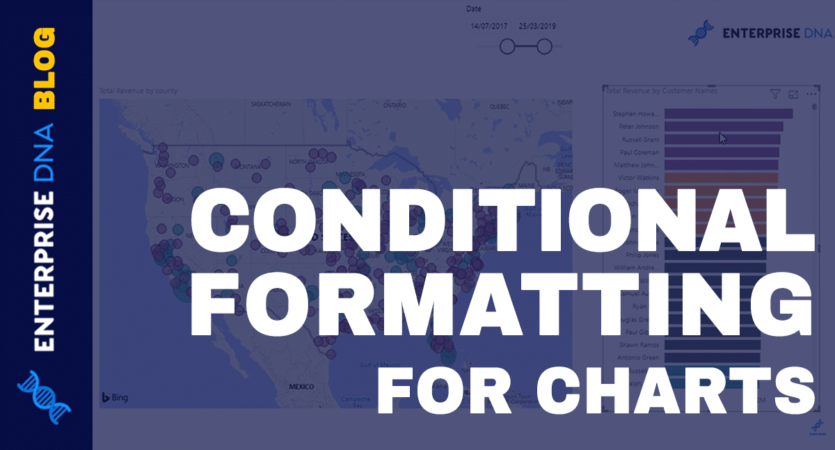

I’m going to talk about how the Power BI conditional formatting feature can take your reports to the next level. It’s a really useful feature, but not a lot of people use it mostly because this function is buried under Power BI’s other tools. You may watch the full video of this tutorial at the bottom of this blog.
The conditional formatting feature in Power BI holds a lot of value from a visualization point of view. It can also potentially simplify the way you model your data.
